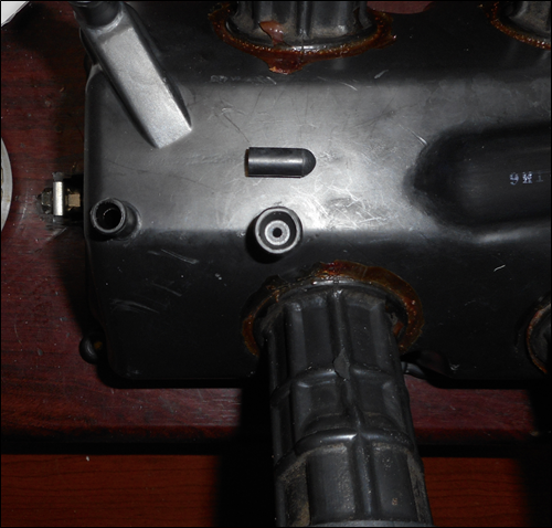

Intake O-rings will leave a brown tell-tale stain when they are leaking.  Photo from Valkpilots's post (http://www.valkyrieforum.com/bbs/index.php?topic=95448.0):

I went to the garage and looked for those telltale brown stains.  #3 and #4, definitely.  #1 and #2, maybe...I'll get a better look when I take the pods off or light it up with my trouble light.  So, we now know at least some of my problem.  I'll order Red Eye's set of o-rings and replace those as well.

Starter fluid test confirmed it.  Intake o-rings leaking bad, especially 3, 5, and 4.  Glad  replacements are already ordered from Red Eye Rich.  Meanwhile, the Seafoam has definitely helped.
