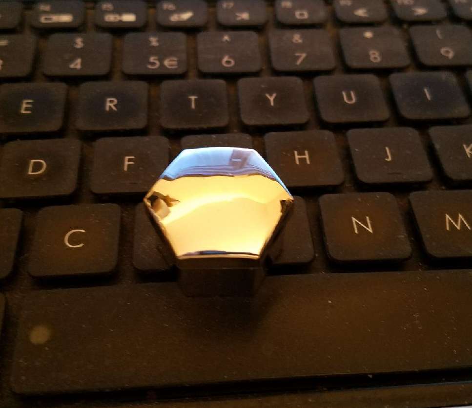

The mod is prototyped and tested on my Jade.  I'm pretty happy with it.  All the parts except the OEM sidestand and the internal nut, are polished stainless.  Oh, and the chrome nut cover.  OK the FOOT is made of 0.120 wall 304 SS, polished.  The bolt is SS.

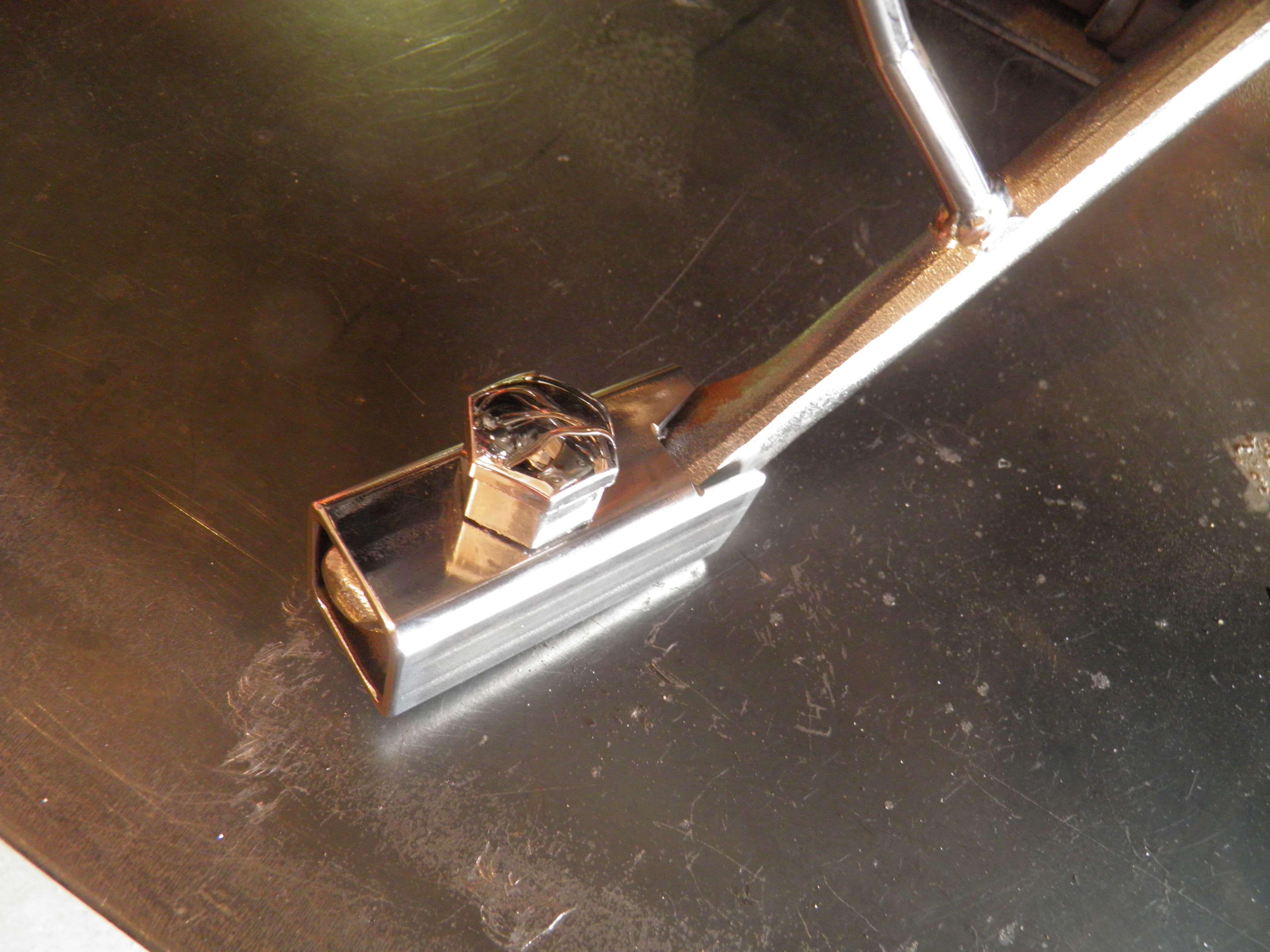

BIGFOOT supports two levels of lift, 1-5/16" and 11/16".  Height set by you.  The bottom face has slightly more area than the OEM foot, and it's flat so it should resist sinking in hot asphalt slightly better.  Also, this is light enough in weight that the sidestand spring supports it OK.
Here is BIGFOOT in it's HIGHLIFT setting, lift 1-5/16". You can simulate the change with a 2X4 which is slightly higher than the high setting of BIGFOOT. The goofy looking top of the nut cover is a reflection.

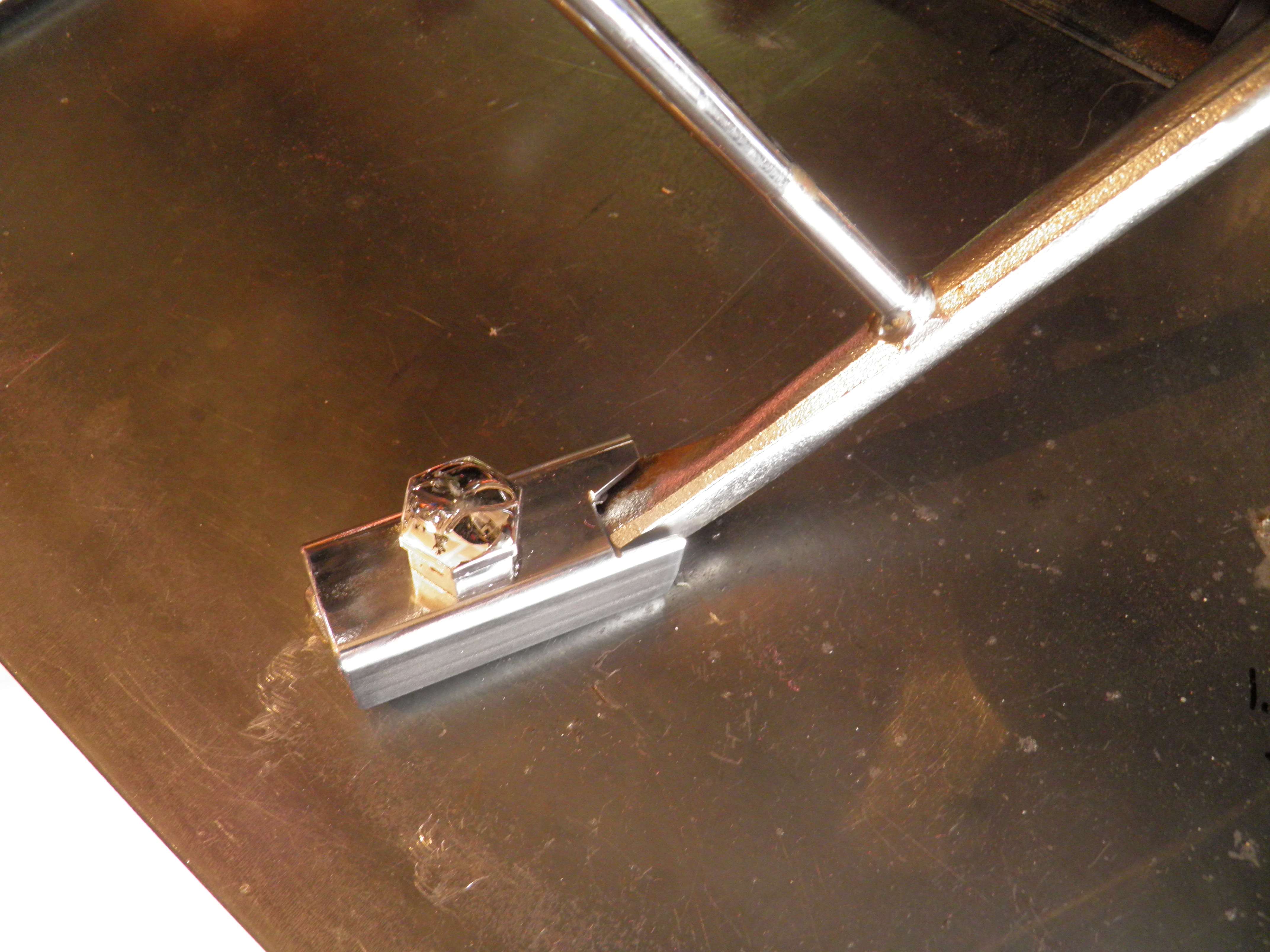

In the lower, 11/16" lift setting:

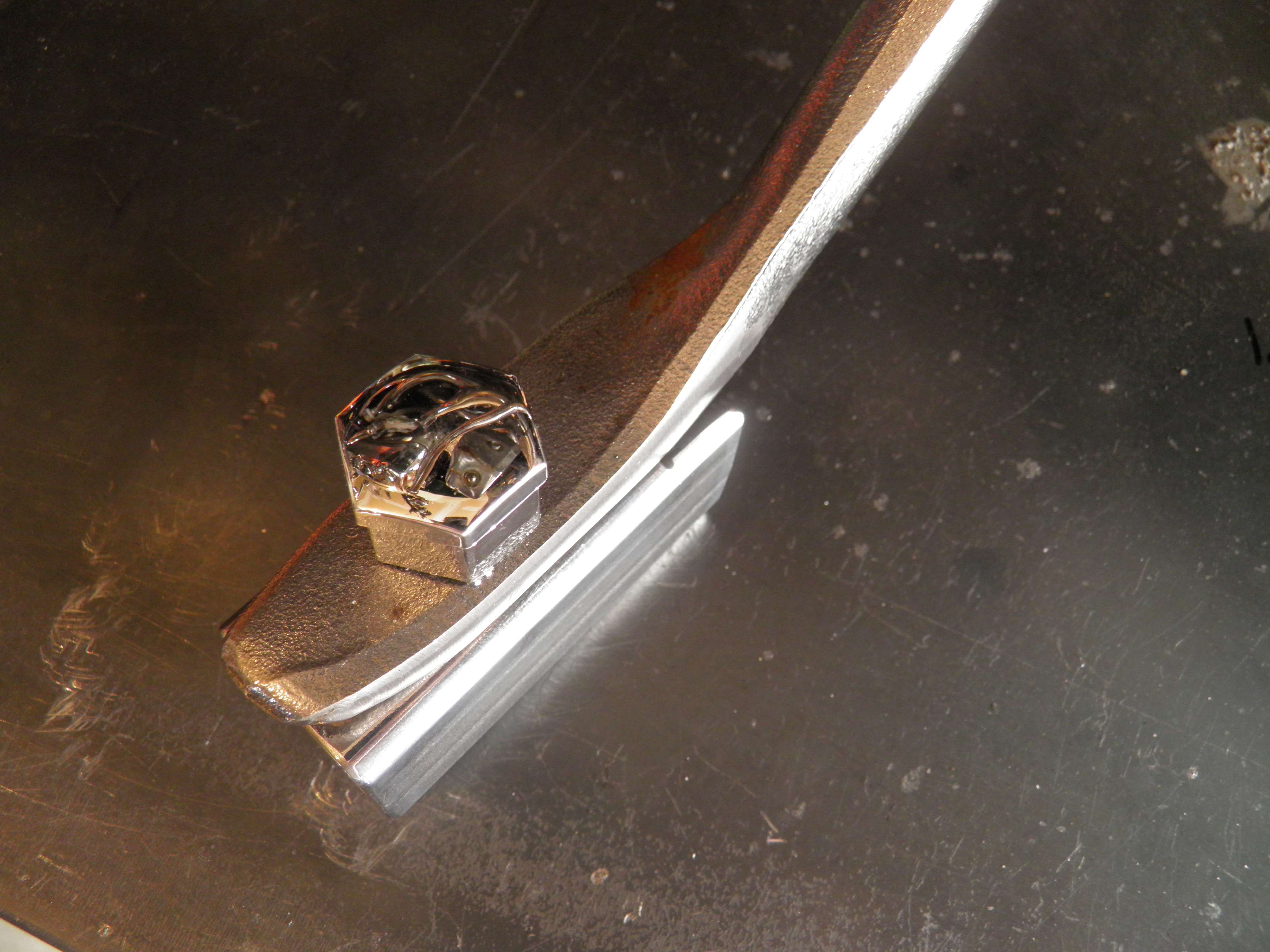

The parts.  Note the weld on the bottom - stops the foot from twisting in the high position.

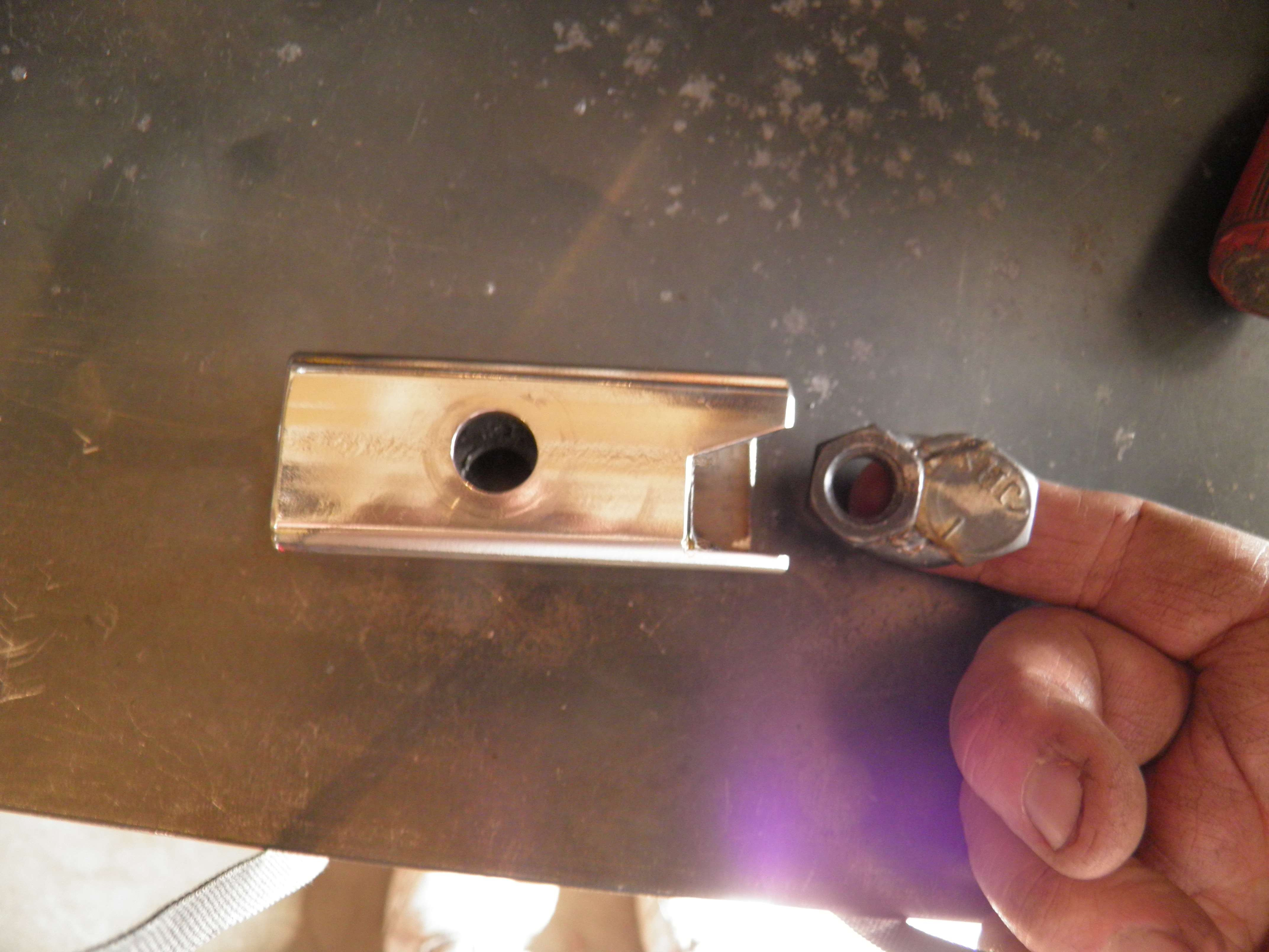

Installing the foot:  put the nut with side lever inside:

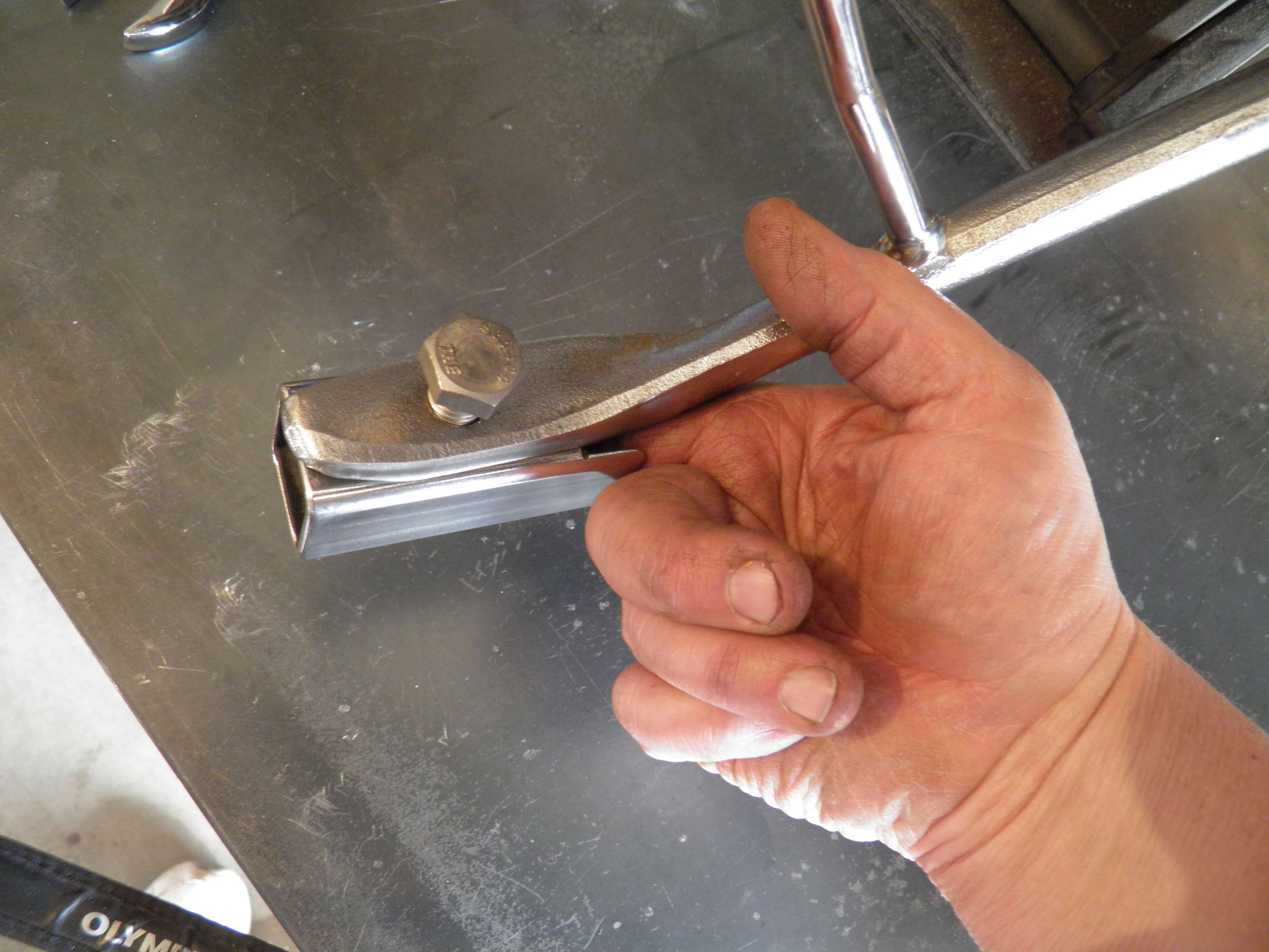

Install the bolt & tighten:
Tap the nut cover on:
