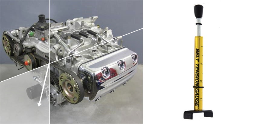

So I looked up the timing belt/s tension adjustment and it is 5 to 7mm (1/4") deflection with 4.5 lbs of force. Hmmm...most tools I see for belt tension are set at 10lbs of force. Are most guys just winging it for the Valk? Smiley There is no mention of a special tool in the Honda shop manual. I suppose using a 10 lb guage you could only press it half way down, but I'd question the accuracy of that. Conversely, you could assume 10 lbs of force should deflect the belt 1/2". Yes I am OCD and if it isn't perfect it isn't done right. Lol
« Last Edit: April 09, 2018, 04:50:47 PM by Harryc » Logged

« Reply #47 on: April 10, 2018, 09:25:39 PM »
The problem I'm having is hooking the scale to get it to pull straight up or down. Something always gets in the way of the lanyard and you end up pulling the scale at an angle. The vector makes the scale inaccurate since the belt gets slightly twisted where you hook the scale onto the belt. The twist in turn throws the true deflection off. It's a bigger problem on the right belt since you have to pull the scale up and pulling up you run into the radiator overhang so you pull the scale at more of an angle. This is on top of a luggage scale's inaccuracy at the 4.5 lbs lower range. I haven't tried a belt tensioner gauge yet. Yea, perhaps, it's simpler to let the tension springs get you in the ballpark. Then fine tune it. Anyways, just thinkin out loud.

« Reply #48 on: April 11, 2018, 03:02:32 AM »
The guage you pictured Ron is most likely one of the 10lb ones that I saw as well. I might just get one and fool around with calibrating it to 4.5 lbs with a fish scale or some sort of scale.

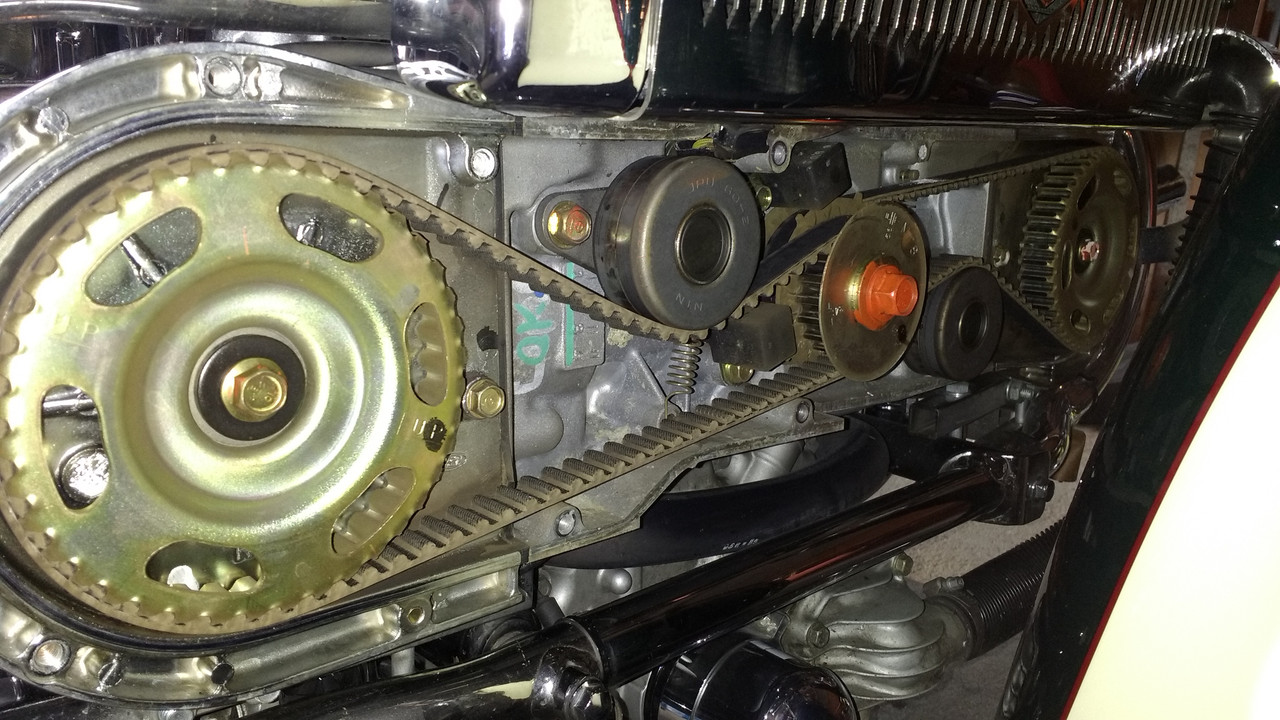

« Reply #54 on: April 19, 2018, 04:53:57 PM »
Did the job today and I took Chris's advice and just let the springs set the tension. Seemed like it worked to me. I'll check it in a few months.  Just as a side note...after 20 years and 36k miles the belts looked good. If anything there was slight wear/unevenness on the top (non-grooved) side of the belts from riding the tensioner pulleys. I'll be long gone before they'll need replacement again, and the next owner can worry about it. The bearings in the tensioner pulleys spun well and free. (The pic below is a right after i took the cover off)
« Last Edit: April 19, 2018, 05:07:25 PM by Harryc » Logged
« Reply #55 on: April 19, 2018, 07:23:02 PM »
Dang, Harry. Your bike is even spotless under the timing belt cover.  Wink

Harryc
Posts: 765
Sebastian, Fl
« Reply #65 on: April 21, 2018, 12:52:49 PM »
 Cheesy , it knew I was going in there. Lol

Belt deflection. I forget exactly what the spec is, lets says it's 1/4 inch with 10lbs pressure applied to the belts at their mid points. Is anyone really doing this? What tools/guage did you use?
I used the calibrated thumb method, not wanting to spend $490 for a belt tension tester. How many shops are there that actually have a belt tension tester? There is another tool considerably cheaper, the Krikit tool, but am not sure it tells you how much force is applied to the belt. The belt should be adjusted so that on the long run of the belt, with 2kg or 4.4 lbs of force applied there should be 5>7mm or 3/16 > 17/64 inch of play on the belt. This is per the Clymer manual on page 122. Don't know about the amount of force I applied with my thumb, but play on the belt was 1/4 inch. That was considerably less play than what was on the belts that I removed.
