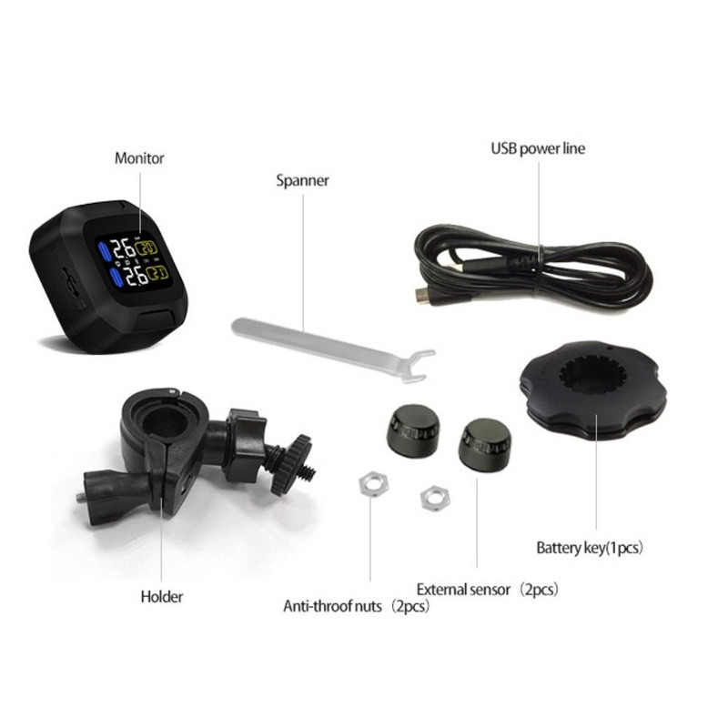

Anyone have any first hand experience with one of the Bluetooth TPMS motorcycle systems and how well it works on a horizontal stem like the Valk has? Seriously thinking about getting that setup just which one...

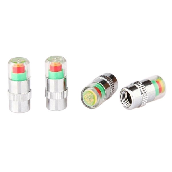

Someone needs to invent a valve stem/cap system that has a colour or display of some sort
I think Beardo had them. And some punk teenagers stole them off his bike.
Posts: 22106
« Reply #11 on: April 19, 2018, 08:33:08 AM »
For $39.95 with Prime shipping, just ordered a set, we'll see how it goes... Been meaning to look closer into this for a while.
Ordered this, no idea if it's any good yet:
https://www.amazon.com/SYKIK-Wireless-pressure-monitoring-motorcycles/dp/B0773SSQJY

Yeah, had/have the FOBO ones. Got stolen, then bought new ones. Once you have them, you don’t want to ride without them. I had my phone mounted to my bars and would leave the app up and monitor the pressure in real time. Was kinda cool to see the big changes in PSI and temp as you warm up he tires.
Really nice to check them every morning. But after a while, you don’t even have to do that. Your phone will vibrate/alarm if they get low.
Not sure if I’ll put them on the new bike, it comes with TPMS, but I think only an idiot light on the model I’m getting, doesn’t show actual PSI.  Will have to see what it has when it gets here.
Been invented.  I had them for a while.  Didnt care for them.
I have them on my cars. They work pretty well. You can get them in any pressure value you want....
Any specific issue Chris?
Posts: 5197
« Reply #26 on: April 20, 2018, 09:04:01 AM »
As long as they don't leak.  I've used them quite a bit but they can cause the leak they are supposedly monitoring.  I got the 42# ones.  Green end when good so you can see that at a glance.  Since I went to Ride-On to balance I've never had a quick air leak so I stopped using them.  Typically check the pressure when I think of it which might be every 2 weeks or before a big ride.  The Austone likes higher pressure so I run it at 43# and it stays there pretty well.  I run the BT45 at 38 since it's bias ply.

After 2 rear tire failures, while my wife was on the back, I now have those air pressure valve caps.
During our GW annual maintenance day, a rider came in with TPMS on his GL1200, so I went out and bought one too. Currently have the 90' valve stems, metal, without the supports, so I'll find out how well they last. Will see if I can put the supports back on. Other wise, I'll be swapping the 90' over to stubby straight ones the next time the rims are off the bike.
The TPMS system I bought 2 weeks ago, I'll put the mounting screw through my fairing, and will be able to screw it on/off when ever I want to, rather than mounting it on the handle bars. The sensors have a lock nut for securing as an anti theft.
A quick glance. Pressure doesn't matter (mine are 36 psi), only that they are in the green ($4 CAD).
This one with a display. Charges with a USB, which has been reported as working for months before needing a charge ($66 CAD).
Who makes the TPMS?

I bought the FOBO  TPMS last year and they worked great. Good peace of mind when you only have 2 tires under you arse. Bought new batteries and reinstalled yesterday. Had removed them and batteries for the winter.
Software is a little slow but worth it.
Managed to put 120 miles on. First ride this year, color me happy.

I have the Kufung Bluetooth TPMS on my bike. Very easy install. Just open the app on the iPhone and get your tire pressure and temp. You can even set up low pressure alarms on them. Had them on since before Christmas and no issues as of yet.

Follow up;
I had the TPMS system sent to my USA mail house, instead of home. It arrived in 2 weeks instead of 3 months.
Put my MC on the road yesterday. Check those pressure indicator caps, all good. Mounted the TPMS system, put the front cap on, and it showed 25 psi. Put the air pump on, pumped up to 35 psi, on with the cap again, and the TPMS showed 39 psi.
Rear tire, looked at the tire cap, solid green, off, on with the pump, indicated 15 psi. Pumped it up to 35 psi. On with the new TPMS, showed 39 psi.
I was going to mount the display on the fairing, but temporary on the handle bars, found this was a good spot.
I like, I think it's going to stay there. I left it turned on, went inside washed up, and came out about 10 min later, and the screen was blank. I touched it, and it lite back up. Just need to see how long the battery lasts before a recharge. Rode home, and showed a different temp frnt/bck and the rear psi went up to 39 also.
Conclusion: Those air pressure caps aren't worth S&^t!
Thinking of a second one for the trailer. With how easy it is to mount the display, I can remove it for when I'm not towing.
