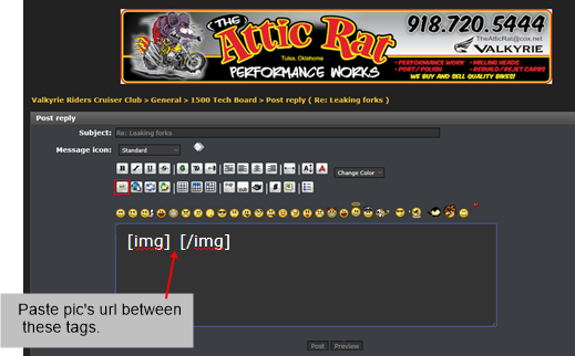

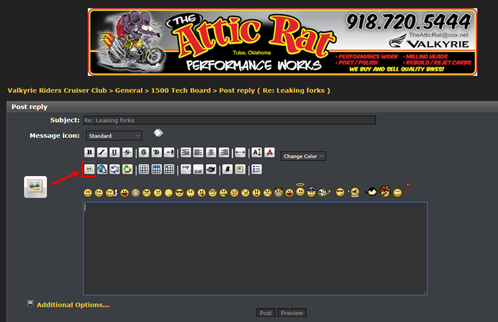

Is there an easy way to embed an image here? I couldn't figure it out.
If it's your own pictures, as opposed to a pic already on the Internet, you'll have to store your pic on a photo hosting website. Do a search on *free photo hosting websites.* After you done that, you next have to find and copy the pic's *url* ..... the pic's assigned Internet address ..... from your photo hosting website. On this forum's editor page, click the *insert photo* button (red arrow). Then paste the url in the space between the opening and closing tags (second pic). Just for practice, go to this forum's editor page, and click the *insert photo* button, then insert the url below between the opening and closing tags.
(copy and paste this url). http://www.valkyrieforum.com/bbs/files/bbs_ads/atticratad.png

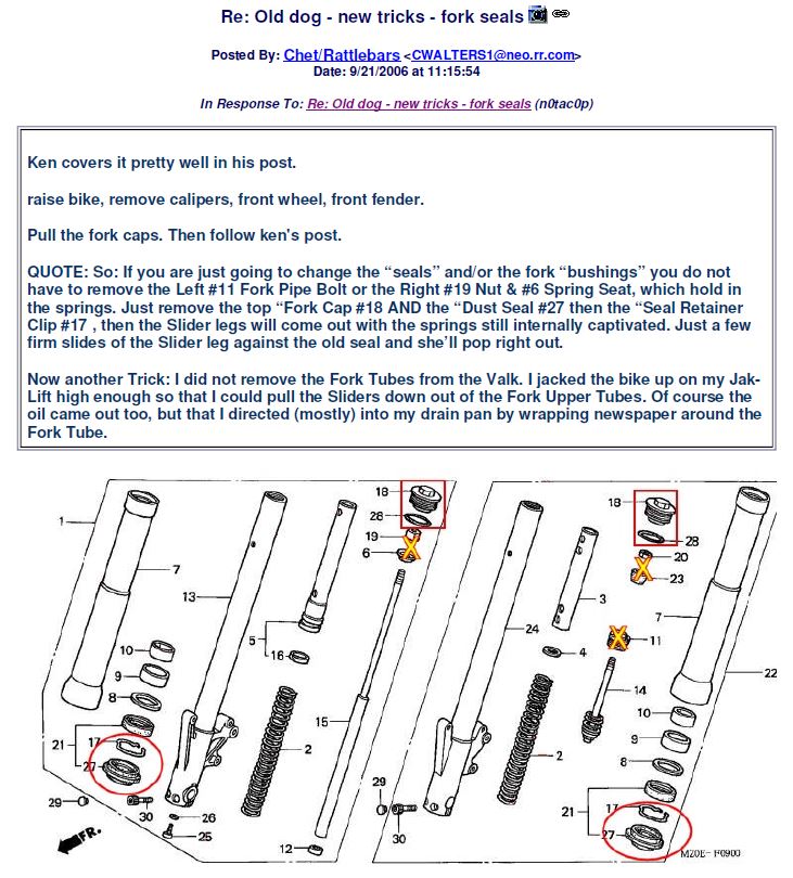

« Reply #49 on: July 20, 2018, 07:50:19 PM »
Here's how to change fork seals without removing the fork or using the special tool:
« Last Edit: July 20, 2018, 08:03:48 PM by F6Dave » Logged

jabster
Posts: 87
« Reply #58 on: August 03, 2018, 02:43:51 PM »
Thanks!
