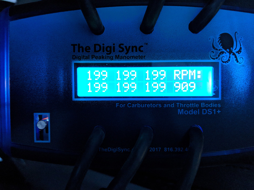

« Reply #27 on: October 25, 2018, 03:41:58 PM »
Final DigiSync.  Can't get too much better than that!!!

« Reply #28 on: October 25, 2018, 03:58:15 PM »
Gotta like that  Digi Sync
Forge
Posts: 227
San Antonio, TX
« Reply #29 on: October 25, 2018, 05:10:11 PM »
Looking good.  cooldude Waiting on the ride report!

« Reply #32 on: October 29, 2018, 08:18:11 AM »
That digisync looks great! I bought one recently and it is currently my favorite tool!

Jersey
Posts: 13704
« Reply #34 on: October 29, 2018, 08:37:55 AM »
Test Rode it today after the rain stopped.  OMG!  What a difference. Major increase in power from idle to 3500prm.  Interesting though, I didn't feel as much pull as before in the 4-6k RPM range.  Maybe it's just because the lower end has increased?
I'm going to do some research on tuning the upper end.  I didn't touch the needle settings, so maybe increasing one step up might be something to consider.  Any suggestions on that?  I'd be interested in hear from those who've used the DynaJet Stage 1 on an I/S.
your mpg will tank with the dynajet.  the needles are too rich unless u have pipes, airbox mods and just looking for max race track power.
suggest factorypro.com kit, which has needles and jets.
