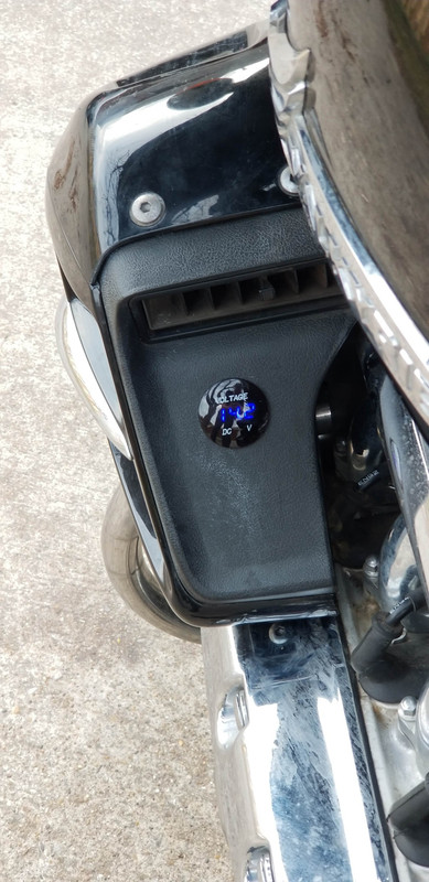

« Reply #45 on: February 04, 2019, 05:23:50 AM »
Thanks for the suggestions, I'm still looking for something that I like aesthetically for my tourer (nee standard) but I got this meter off of Amazon for my Interstate:
https://www.amazon.com/gp/product/B01B4HV0UQ/ref=ppx_yo_dt_b_asin_title_o01__o00_s01?ie=UTF8&psc=1
Drilled a hole in the left radiator pod facing the driver just under the air vent and tapped it into a wire going to a small LED light I added. I know getting the wire as close to the battery is preferable, but figured the LED light draws so little it shouldn't matter too much, we'll see I can pop the tank and re-wire it if necessary.
I like the look so far, the 2nd alternator should appear Tuesday evening, so then begins the rest of the Great Adventure.
Extra frustrating because I'd taken my time being careful to remember what angle I held the alternator, the phase of the moon, exactly how I was holding my tongue outta my mouth, etc while removing the old one just to make it theoretically easier to get the new one in, but now all that knowledge has grown stale, so we'll see.....

« Reply #47 on: February 05, 2019, 02:40:27 PM »
Update: 2nd alternator came today, actual Valkyrie Interstate model number.
Getting it in wasn't TOO bad, I'd rather do that than take the rear end apart.
Even though I had to do it twice because I'd installed the rubber dampeners incorrectly the first time.
Someday I might get the gumption to try to get the middle bolt that I broke off out and replaced, but not today. (Ugh... Always something, but it's good and snug with the top and bottom bolts in place at least.)
Button'ed up and put everything back together, turned the key and my shiny new voltmeter goes to 12.1 volts. Fired up the bike and 13.9, go for a ride and it's holding 14.0 to 14.1ish... So far so good!
So that sucked, but done enough... And really liking the voltmeter, just still need to figure out a solution for the Tourer...
(The display doesn't show up well in the photo, it's much easier to see and read in person.)
