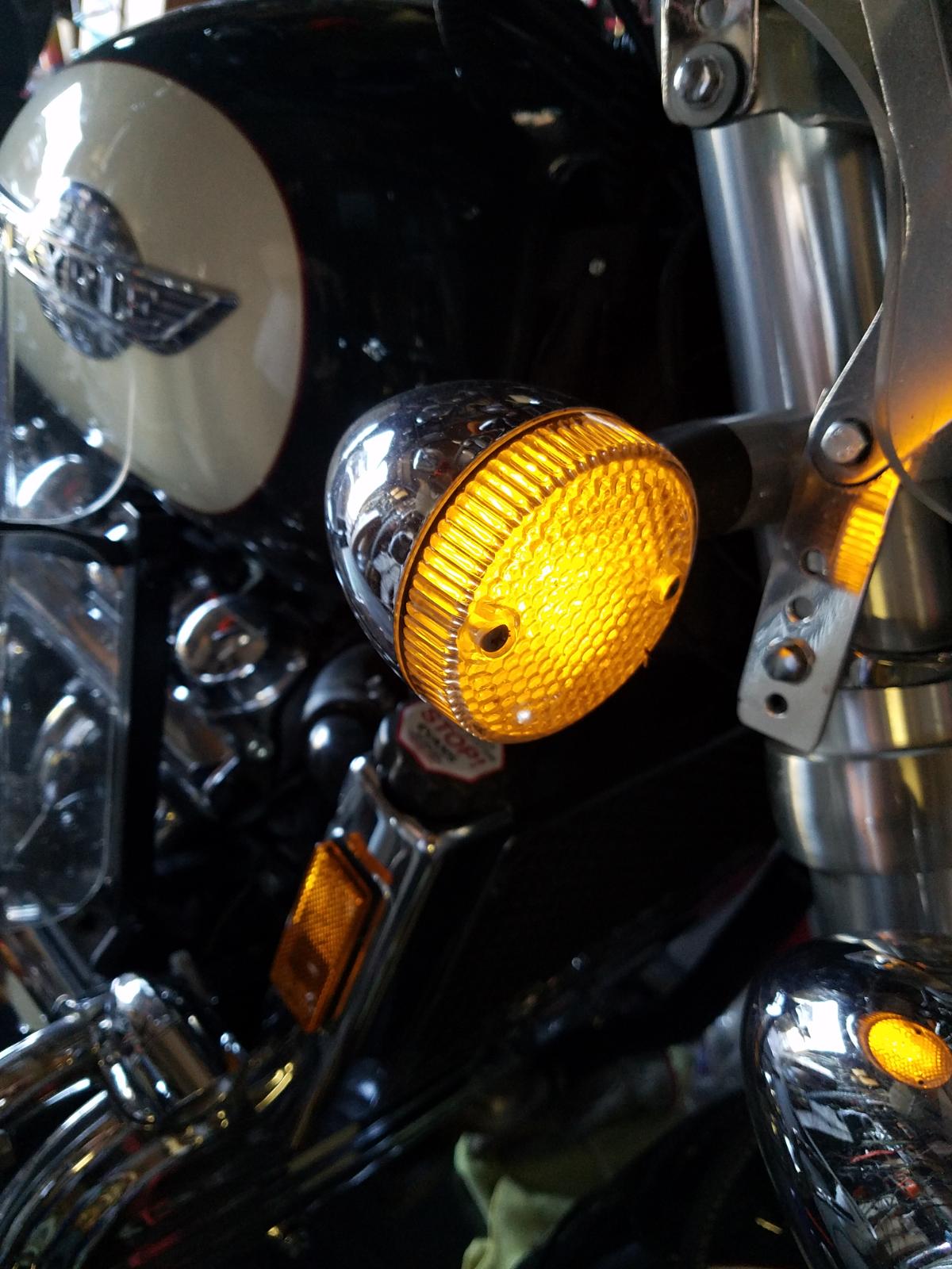

• Front markers orange LED arrays with indicator LED mod.  http://www.horseapple.com/scratch/JADE%20fwd%20marker.jpg

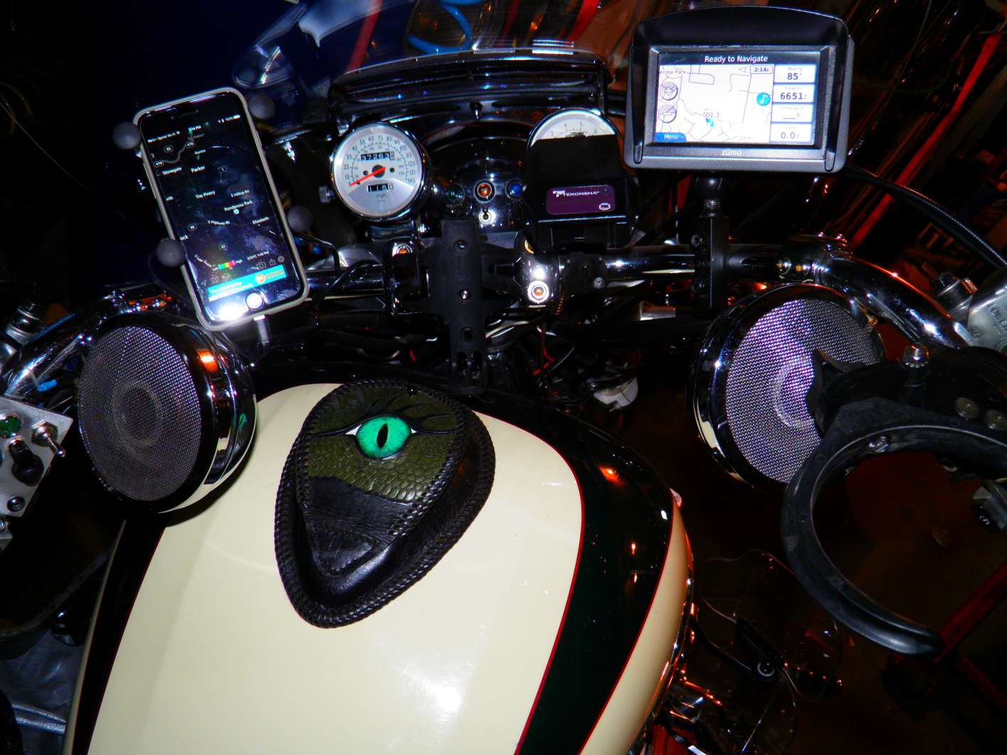

• 300w amp, 300w preamp & mixer with Lanzar Crossover with Bluetooth and Subwoofer support, speakers on handlebar.  http://www.horseapple.com/scratch/Jade%20Lanzar%20Crossover.jpg

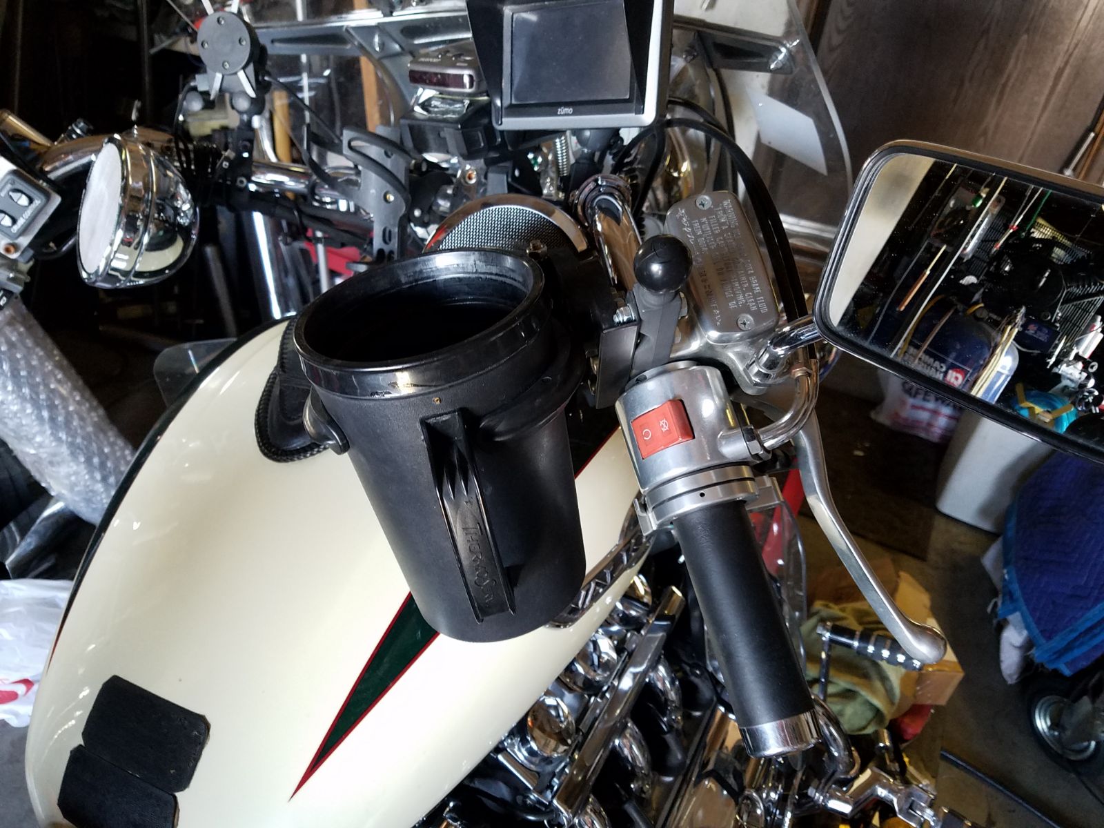

• Butler drink holder.  http://www.horseapple.com/scratch/JADE%20Butler.jpg

• Another drinkholder - works with paper cups.  http://www.horseapple.com/scratch/JADE%20drinkholder.jpg
• Garmin Zumo 665 with XM/Sirius antenna (supports MP3 play, satellite radio, weather and traffic maps)  http://www.horseapple.com/scratch/JADE%20ZUMO%20650.jpg   http://www.horseapple.com/scratch/JADE%20XM%20antenna.jpg

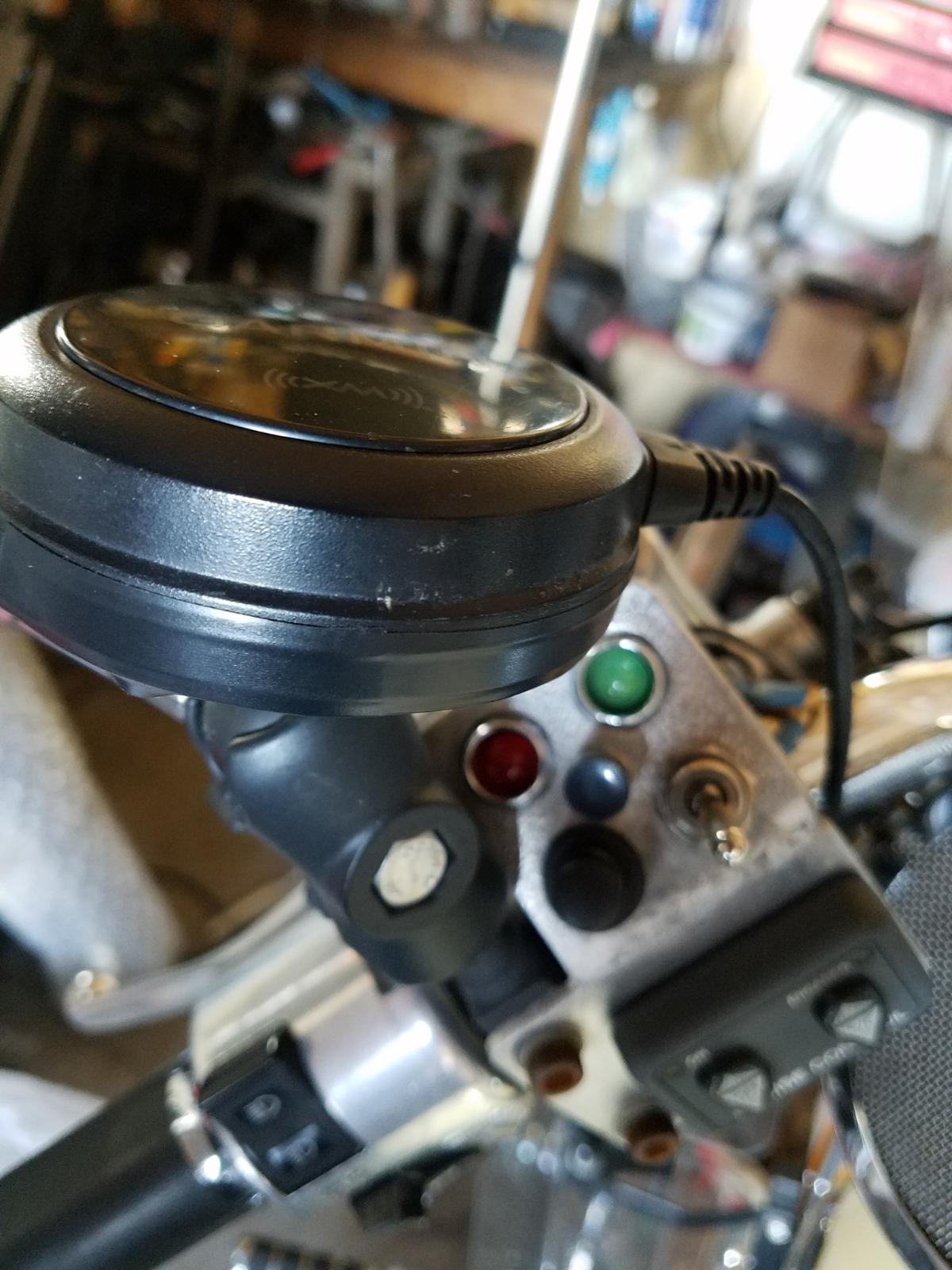

• "X" phoneholder with USB power port.  http://www.horseapple.com/scratch/JADE%20X%20phone%20mnt.jpg
• Escort Passport to monitor charger voltage and the cops monitoring me.  http://www.horseapple.com/scratch/JADE%20Escort.jpg

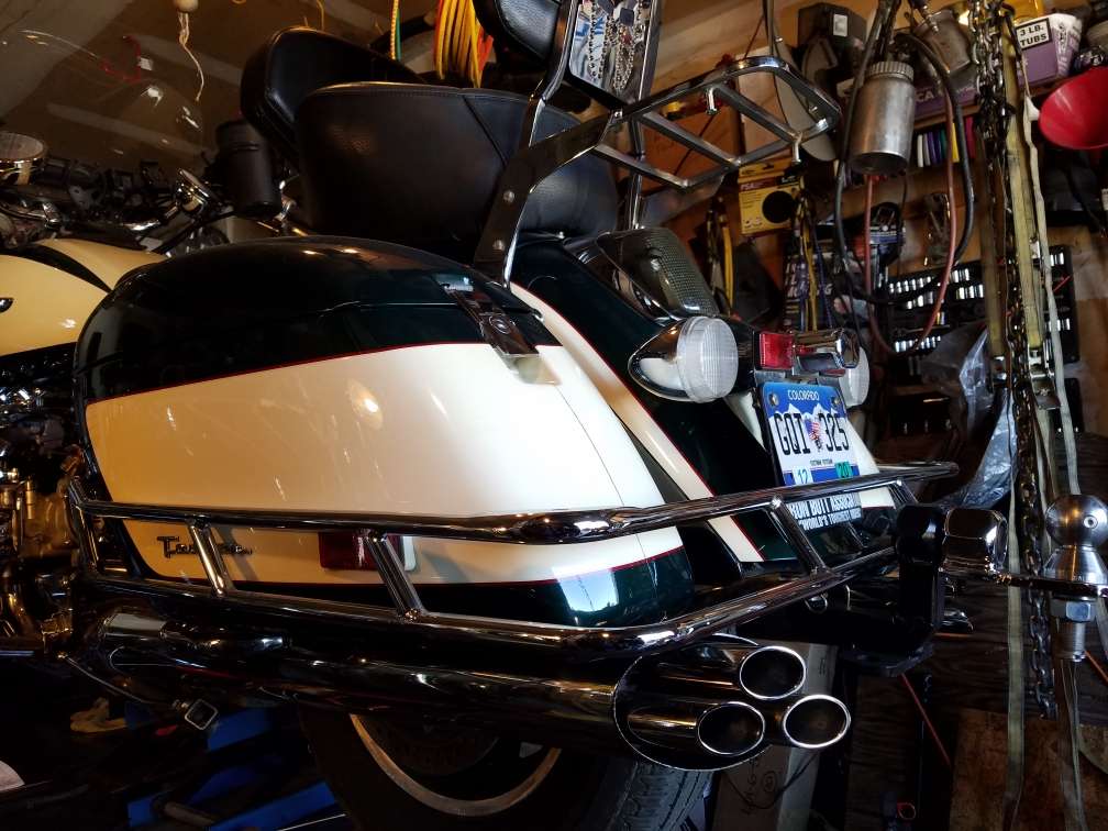

• My custom pipes with glasspacks, silencers and Organ Pipes.  http://www.horseapple.com/Valkyrie/Valk_Products/M2W_Exhaust__System/m2w_exhaust__system.html
• My permanent mounted lightweight lift adapter.  http://www.valkyrieforum.com/bbs/index.php/topic,105040.0.html
• Luggage rack.  http://www.horseapple.com/scratch/JADE%20back.jpg

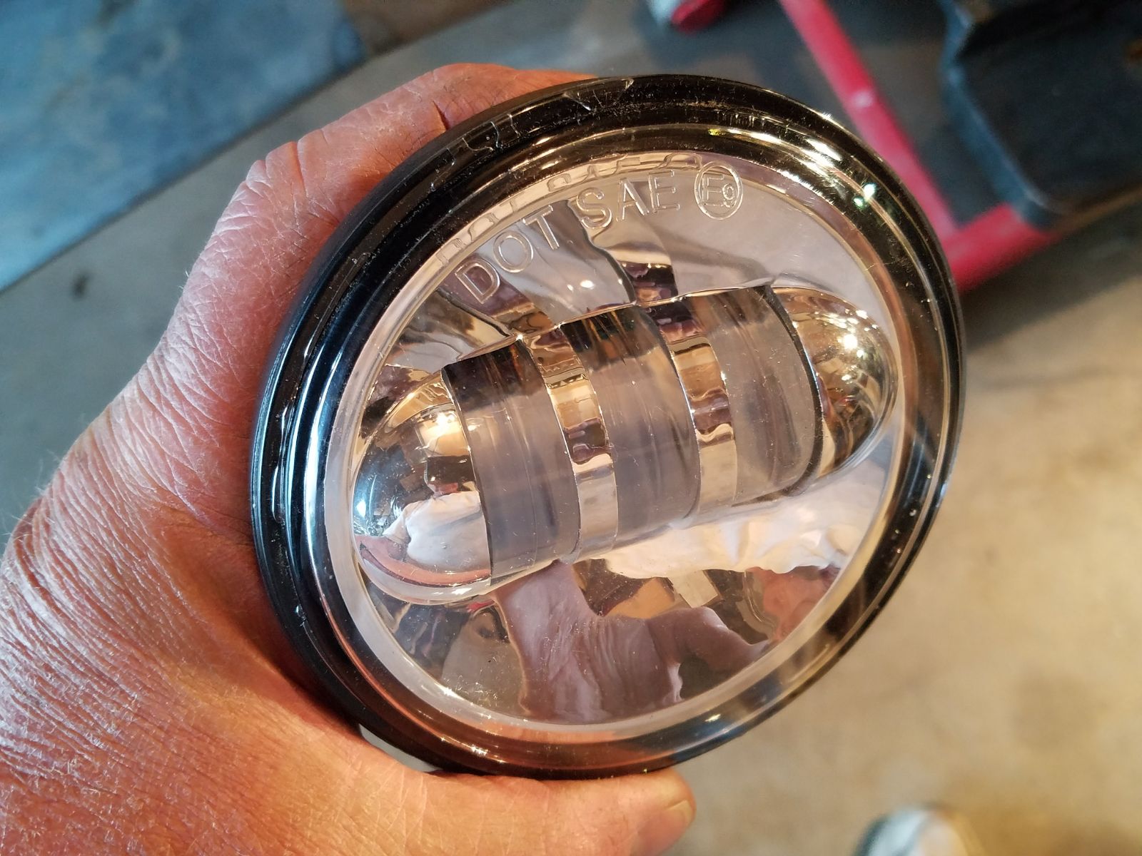

• Changed the main headlight to an Eagle Lights Infinity Beam "dragon's eye" (not their name) And both upper H4 spots to H4 LED's, installed the universal 3 1/2" LED spots in some shells I had on hand with a couple custom brackets I made.  Removed the small LED spots on the crash bars.  Now all 5 lights use less power in sum than the one 130/90 halogen headlight on high beam I removed.  Plenty of forward visibility for safety, a little less light downrange yet enough for deer safety, and much less load on the alternator which I had to replace after the Roanoke inzane trip 2018:
https://www.horseapple.com/scratch/Eagle%20Lights%20Infinity%20Beam.jpg
https://www.horseapple.com/scratch/LED%20SPOT%20FRNT.jpg

• Kenwood 400w 4-channel KAC-M1804 replaced the failed Uniqcycle amp.  Hardwired the Samsung X cellphone mount to the Lanzar Crossover since the Bluetooth connection kept dropping. The phone now has a 1Tb micro-SD card inside with (currently) my 9535 mp3 collection so I can listen to all my tunes using whatever player ap (now Musicolet) is current on the phone.
• Bag rails I bought at the Roanoke Inzane.  Not made to fit exactly my 97 Tourer with Hitchdoc but with some cutting and welding I made it fit.  https://www.horseapple.com/scratch/Jade%20bag%20rails%20on%20lift.jpg
