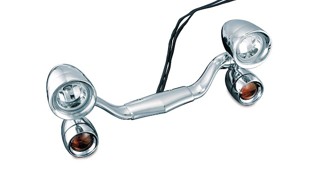

Which lightbar do you have?
Kurt constallation
They had em on closeout few months ago.

Okay, Kuryakyn or Kury, driving lights.
What do folks do with the OEM turn signal wiring going to bulb socket after tapping into the correct wires for the lightbar w/ turnsignals?
The Kury instructions state to tap into the oem turnsignal wires so I surmise you mean what do you do with the dangling oem wires after the tap. You're not planning on keeping the stock turnsignals in place with the wires in tact, are you? 4 turnsignals up front?! Anyways, I don't know why kury does it that way. I would simply crimp a bullet connector to the end of the kury wire and plug the kury wire into their respective oem turnsignal wires in the headlight bucket. Lightbar instructions, here.
If the kury turnsignals use single filament bulbs, you'd have only two wires per kury signal, a ground wire & a +12 wire. If this is so, the kit should include a 'Y' connector for the kury +12 wire. One branch of the Y connects to the oem running light wire (constant ON) and the second branch connects to the oem blinker wire. The leg of the Y itself connects to the kury's +12 wire feeding the kury turnsignal both a steady running light and also a blinking light. The confluence is okay since the the running light's electricity is only ON when the blinker is OFF, and visa versa, so no conflict exists between a blinking pulse and a steady ON light.
On the other hand if the kury turnsignals use dual filament bulbs, a high filament (blinker) and a low filament (running), each kury turnsignal will have two +12 wires and a third Ground wire. You then can plug the kury wires into their respective blinker wire and running light wire in the headlight bucket. Of course after crimping on bullet connectors.
The driving lights are another issue and perhaps a topic for another post. Basically, it's not advisable to tap into a key-on wire to power the driving lights, usually the convenient headlight wire. The extra current draw is likely to overload the donor circuit. Instead, the driving lights should be powered by a direct line to the battery positive terminal with an intermediary relay and a in-line fuse. The relay insures that the driving lights shuts off, won't remain on, when you turn off the key. Kuryakyn sells wire looms for this purpose. Bons too as h13man noted. It's easy to put together your own safety loom, though. I would check out the YouTube videos to get a general idea of the wiring.
2000 Valkyrie Tourer
