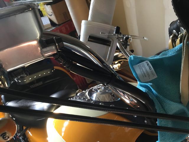

There's seems to be always bits and pieces of items to drive you crazy on a rebuild of a Valky.....  uglystupid2
Ok on this one, it seems to be that the stock brake line is too long... (huh?) I took it apart and didnt notice. Wait, how did that happen? ------And now I'm checking the SS length and jeez, it looks like maybe  2 1/2 inches too long....ok what happened here? Check the stock line photos... I am inclined to spec the SS top to m/C lines much shorter....
Askling for opinions...
So... Stock line with the line relaxed.... too long?

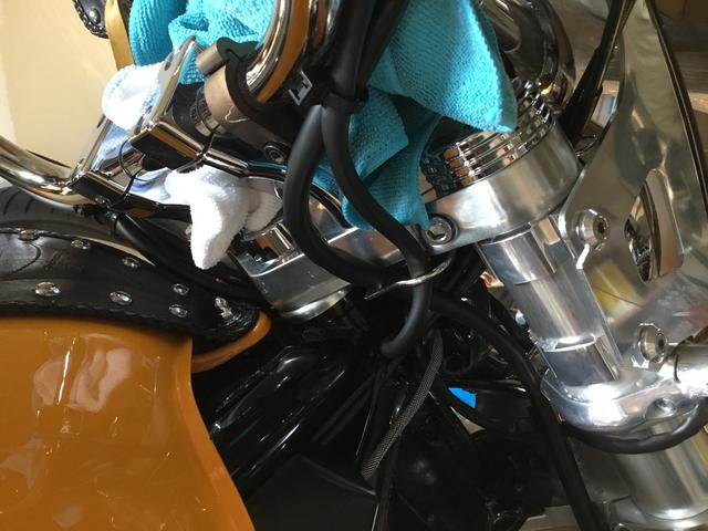

Ok so if I just bolt up the banjo... I get a large "bowing" in the steering head...
Then showing the excess slack --(where did that come from?)

Are you sure you have the lines routed the same as stock?  Perhaps you re-routed the stock lines at some point due to aftermarket risers?  The front of the service manual has diagrams showing routing of all tubing and cables...might want to double check before ordering shorter cables.
Good luck...
+1
page 1-21 Std, shows a bow at the triple tree.

Then you’re as good as gold...here’s mine...just replaced last year with oem lines.
That's called stress relief.

Same guys I work with...  Smiley - So I'm kinda concluding that I'm head banging over nothing.
(Really if you look at it, where the line crosses the lower triple, its gonna wear out/cut eventually, dunno about Honda on this one. )    --Look at the bottom photo...
-->The SS lines are getting whacked shorter..
