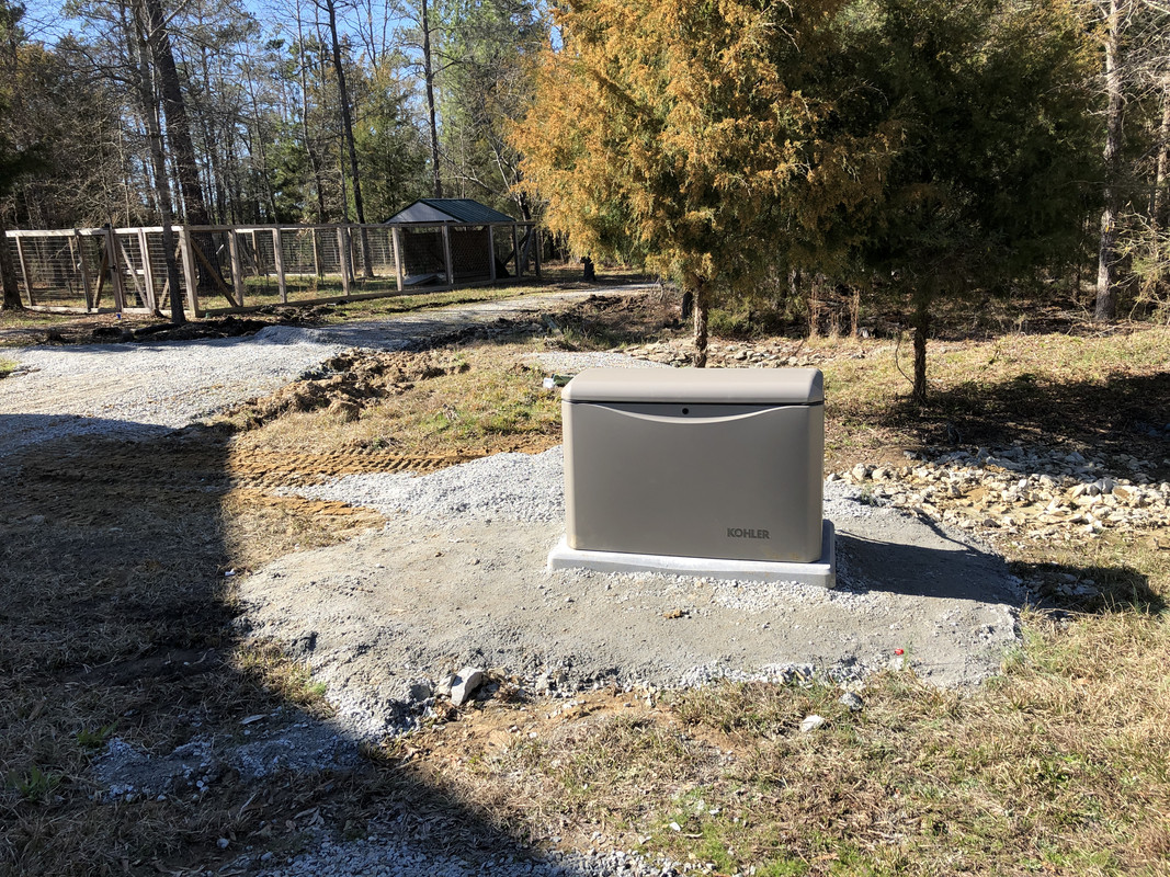

After research and consideration of costs and returns, ease of use, and reliability, I have decided to install a whole house back up generator.
I live in a small town (within the city limits) and power is supplied by the town.  Power line maintenance is sort of hit and miss and, since I am at the end of the supply line, anything that happens upstream of me causes me to lose power.
While it does not happen often (generally two or three times a year) my wife usually gets a little upset when it happens.  So, in order to preserve peace in the house, we decided to install a backup generator.
Options were a manual start generator (preferably inverter power and runs on natural gas) or a stand alone always installed and connected generator.
For the stand alone unit two generator types were investigated, a Generac or a Kohler.  Based on research I decided that the Kohler standalone always connected unit would be the best and most reliable choice.
The Kohler is rated at 20KW but uses a standard generator for power production  Frequency response, I have been told is very good (59.9 Hz to 60.1 Hz).  This response is contingent on a couple of things, throttle response and fuel supply.
For fuel, Propane was an option but since I already have natural gas it was the best and most economical choice.   When I built the house I did some research on generators and requested that the natural gas supply line to the house be of sufficient size to provide natural gas for a standby generator.  The only draw back to using natural gas is that the generator's maximum available output is a little less on natural gas when compared to propane.
Also, during times when power outages are possible (hurricanes, ect), natural gas lines are "packed" by raising the pressure in the lines a little to ensure a more constant supply in the event of power outages (allows time for generators to kick in to keep the pressure up).
An automatic break before make transfer switch will be installed between the utilities power meter output and the supply to the house.
Time frame for transfer is about three to five seconds after sensing a loss of power.  To transfer back to normal power, the switch has to sense that power has been restored for several minutes before making the switch back to normal power.
While I don't think it will be a problem, there is one issue with the installation that is a little concerning.  A load reduction device will be installed so that if a large load is started, an automatic "load shed" operation will take place.  The main device that could cause this is the HVAC system.  The reason is that when a compressor (motor) is started, the initial current surge is large (think like a short circuit because its just wire).  That does not last long (maybe a couple of seconds) but it can affect the generator's output frequency if the generator is near a given load point.  So, there will be a connection to my HVAC system to prevent it from starting at a given set up circumstances.   I have asked the installer to ensure my HVAC supplier is involved in this "operation".
The generator is covered by a 5 year parts and labor warranty.  After five years, I will have to see what options are available for service and maintenance.  I can do my own maintenance (after all I work on my bike), but... as I get older.....
Life span for a well maintained generator is (according to the web search I did) is said to be 20 to 30 years.  Since I am now in my 70's  thats sufficient for me.
While the generator is not noisy (62 DB or so when running is what I was told but can't confirm that) it will be installed about 30 feet from the house.  This adds about 10% to the cost of the unit and installation.  But I'd rather not have it next to the foundation for several reasons.   Access and drainage are two reasons.
Cost of operation is not well known.  I have been told, when running under nominal load, the daily operational cost would be between $20 and $30.  Not confirmed.  Other costs of operation are the weekly self tests where the unit starts and runs (at idle not connected to the house or loaded) for about 20 minutes.  During this time diagnostics are run and the unit sort of checks it self out.  This adds about $5 to my normal natural gas monthly charges (not verified).
One last note, a program called Oncue Plus is available (I opted for it) that will allow remote monitoring of the unit.  Needs an internet connection which I will run from one of my internet switch to the general area.  Oncue has an app for iPhone and Android devices.  Also can run it on my laptop.  It does not add signficanlty to the cost of the unit (about 2%) so installing it is sort of a non issue cost wise.  And it will allow me to monitor the unit and sense power loss when I am not at home.

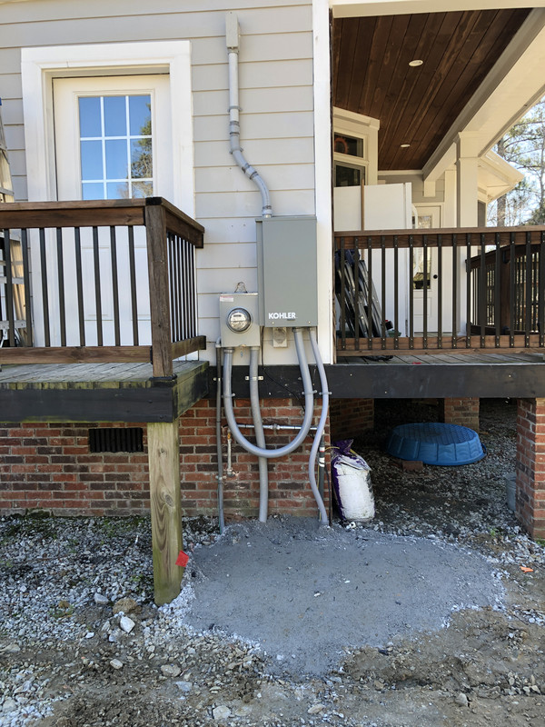

I will provide more updates as the install progresses.  Just finished getting a CAT 5 cable ready for connection.  Lucily I ran a couple of extra CAT 5 cables under the house and up to the router/switch.

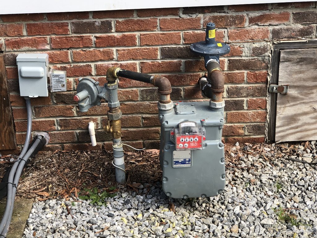

Update on installation -
Weather has been an issue so installaiton has been delayed.  But on Wednesday the natural gas system was upgraded.
Gas line regulator/meter was replaced with a 2 PSI regulator (at least I believe that is what it was) and then 1.5 PSI regulator was connected to attach to the house feed.  All done outside of the house.

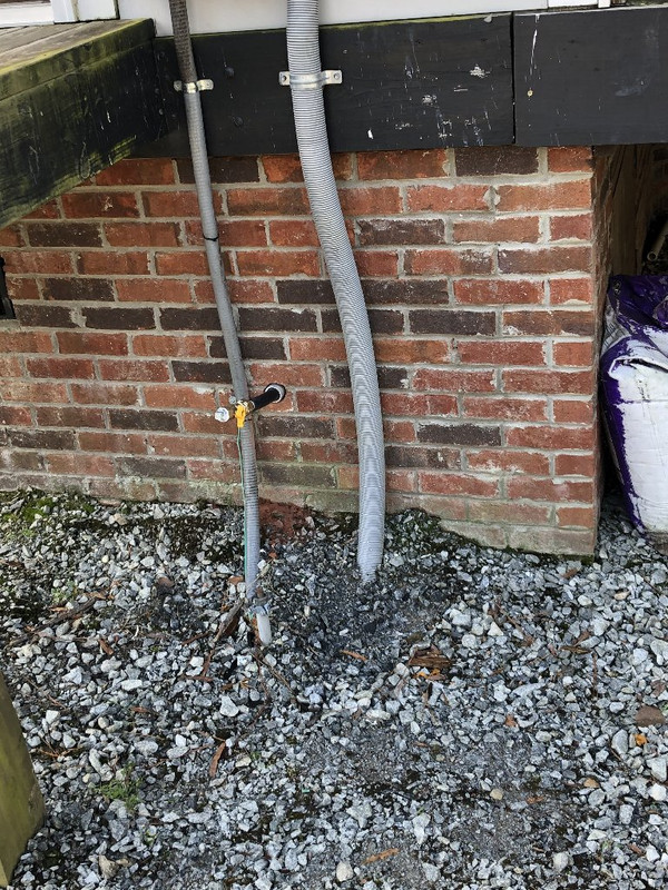

Then two holes were made in the curtain wall for the natural gas line that will supply the generator and the line run under the house to the location of the generator (actually will be located about 30 feet from the house.
Took about two hours to complete this part of the project.

Generator, transfer switch and load reject device installation was finally completed today.  Lots of rain held things up.
Had to be without power for about two yours as the connections were made, wires re-run, and changes made to breaker box.
Load tested satisfactory.  It is set to start every two weeks to run, unloaded, for about 10 minutes.
The connection to the existing circuits are a bit messy but, a certain code requirement required the transfer switch to be mounted with its internal circuit breaker no more than 6' 6" off the ground.
I was told the engine holds a little shy of four quarts of oil (not the two quarts I was lead to beleve from my re-search on the web).  Will verify with provide documents.

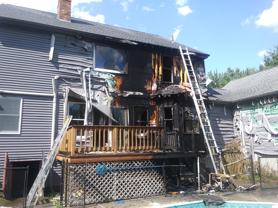

« Reply #28 on: August 07, 2020, 05:13:27 PM »
Be careful were you install them.
That's what this was, a portable that was installed in a semi-permanent way.
This happened this past Wednesday after ISIASIS tore though.
Fire Chief thinks the gas line deteriorated from sitting outside for years.
Caught the deck on fire, then the house, before the woman living there noticed.
I went home and moved mine 10 ft more away from my house.
