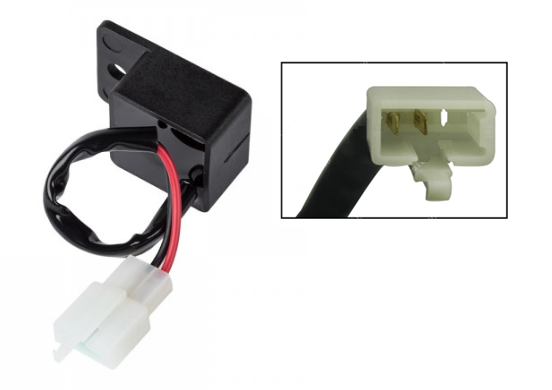

Electronic flashers don't need a ground wire. That's why only the 2 wires although many led flashers include a ground wire for whatever reasons. Also, different brand electronic flashers don't reduce the hyperflashing equally, and the reduced rate varies if you were to add leds to your rear signals, 4 leds instead of 2 leds.
I've tried the superbright flasher that Oil Burner linked to and it works but it does not reduce the blinking 100% back to the stock rate, but the slightly faster blinking is better in my opinon. It has a mini pin-connector (inset photo), otherwise you'd have to crimp on ¼-inch female blade connectors to the harness wires ..... in respect to plug-n-play.
