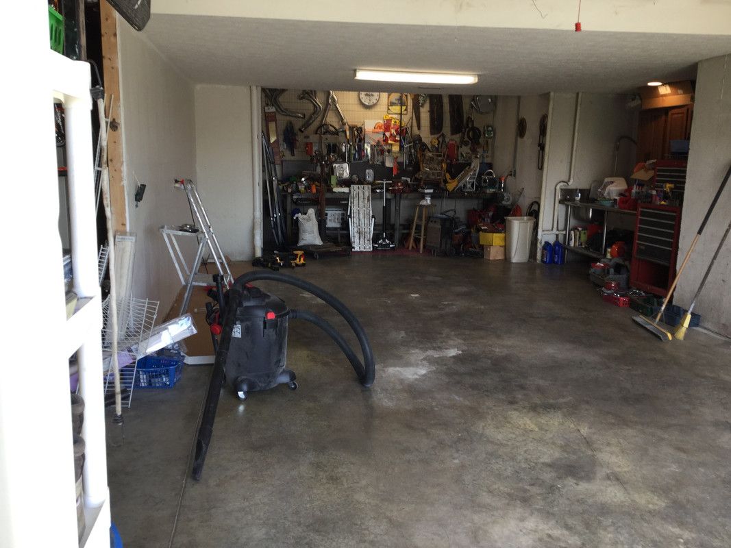

I’ve been busy this week trying to make my basement garage/shop area more conducive to use and improve the flow of things. The more things I move the more grime I uncover.

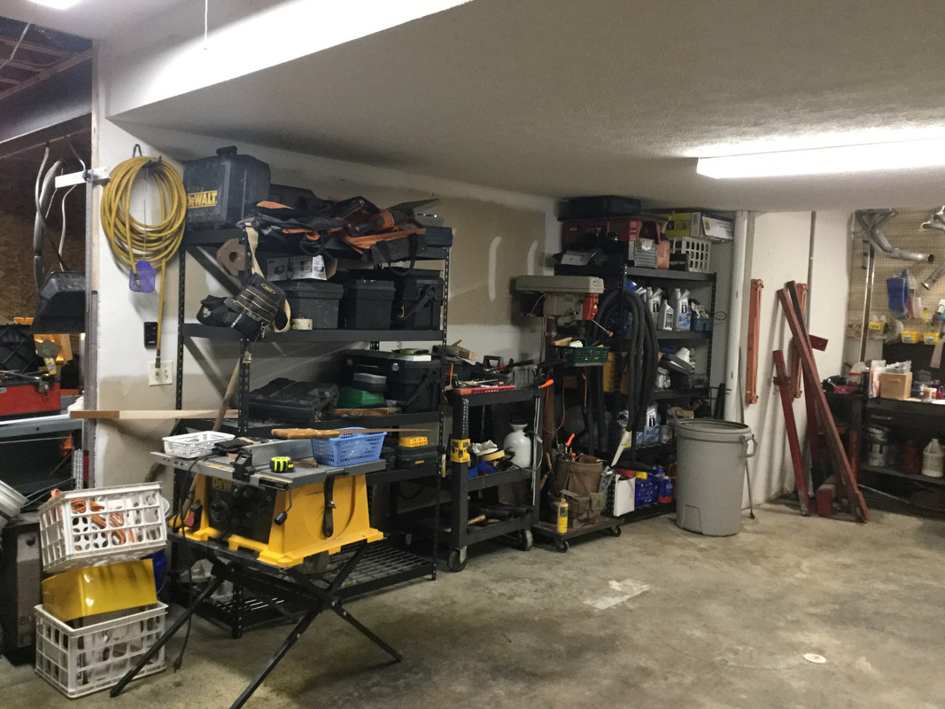

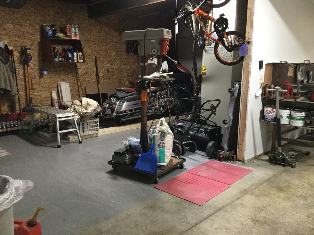

This wall is one of few that is drywall with most walls being poured concrete. I bought storage racks to hold a lot of my construction tools and this wall has a offset so that it doesn’t impede vehicle parking.
As you can see that wall had never been painted and so I found a new home for the racks and after priming and 2 coats of white paint it looks a little better.

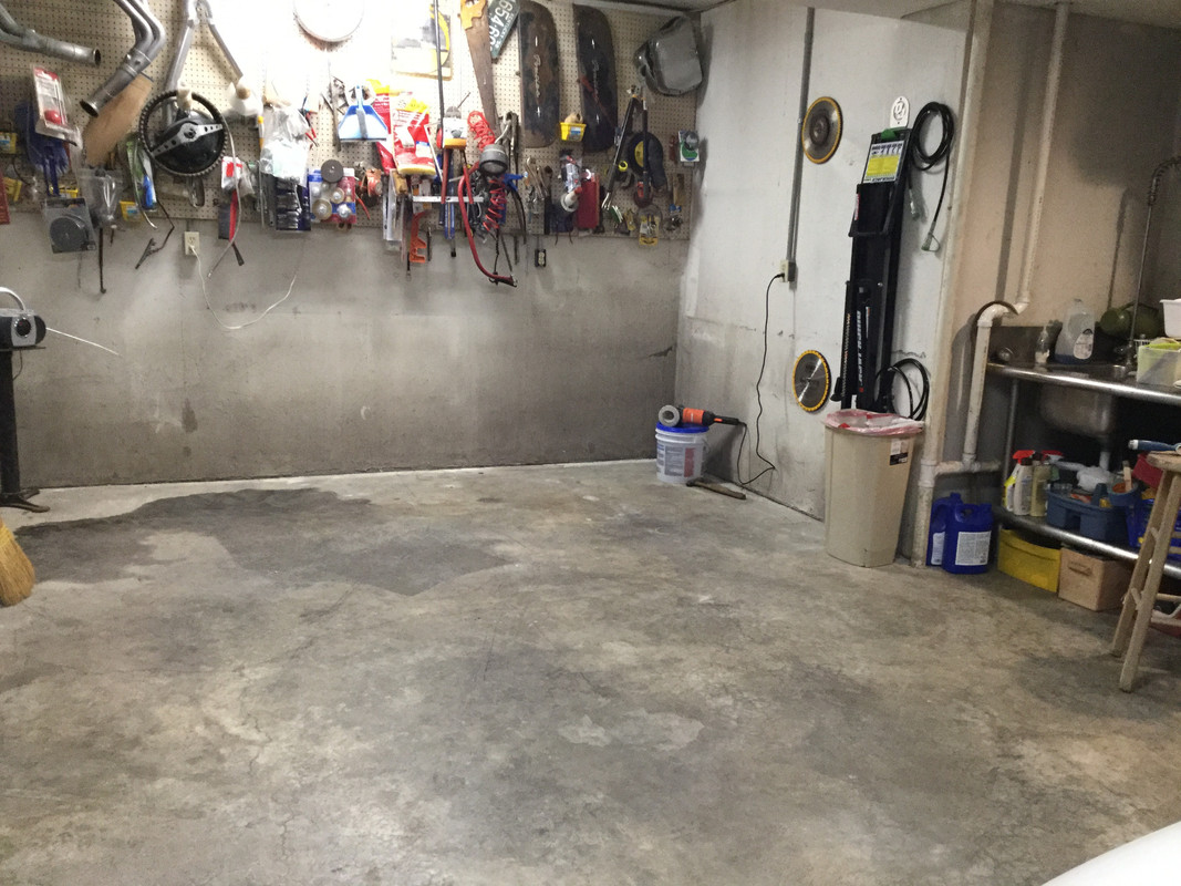

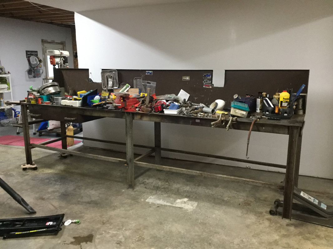

Across the end wall is a 12’6” steel homemade workbench that was left by the previous owner. He was a farmer and the treated this area as if it was in a shed in one of his barns. I’ve cleaned it once using various solvents and scrapers and it’s still dirty and unsightly.
I decided I needed that space to create more room for hopefully parking two vehicles end to end. So I decided to move the bench to the offset space that the storage racks used to be. Moving it turned out to be more of a job than I anticipated. The table is 1/8” steel along with everything else. The floor jack and casters worked but it was a slow go.

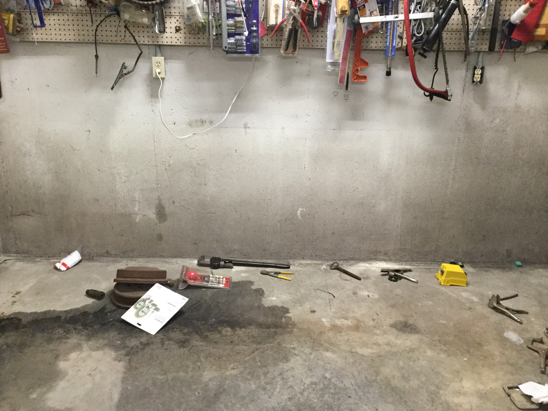

The workbench had never been moved and the walls behind it suffered the consequences.

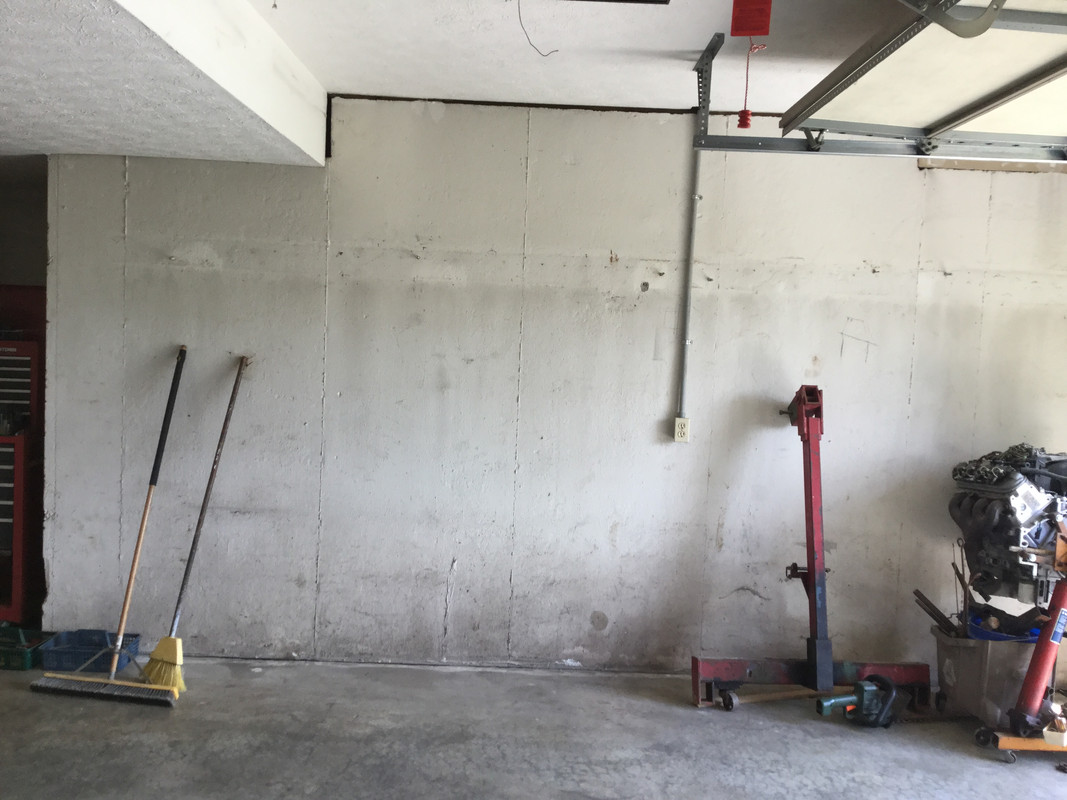

The wall opposite the the new workbench location is not much better. I’m trying to decide what to use to clean them before painting. The walls have a white waterproofing coating on them now so all I’m concerned about is getting any oil based grime off so I don’t have adhesion issues.

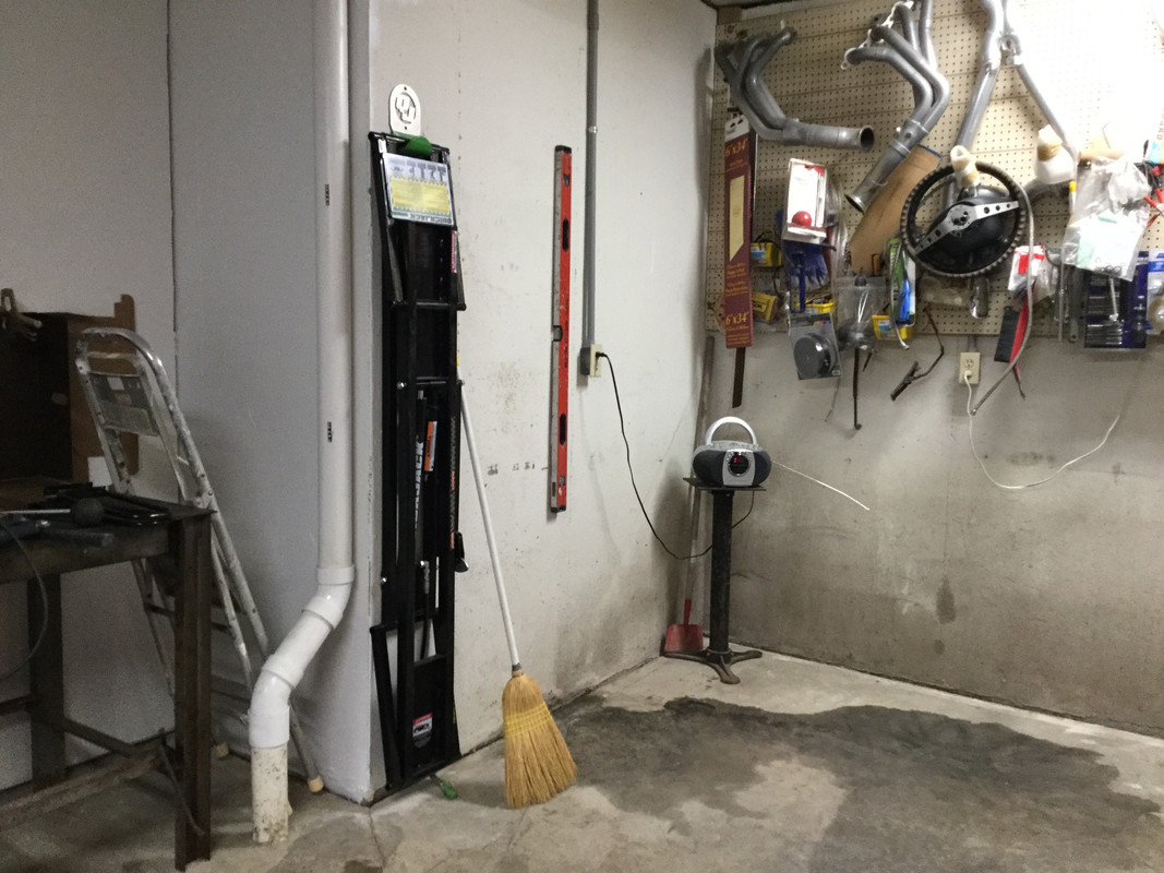

I did go ahead and mount the hangers for my Quickjack. I’ll have to take them back down when I paint but I wanted to get the concrete drilling out of the way.
I mounted them on opposite walls because they have to be slid in on each side of the vehicle and they are heavy
To make it more Valkyrie related, you can see the bike in its current resting place.

John, I don't care how dirty stuff is, I'd kill to have that kind of work and storage space.
But nice work.   cooldude

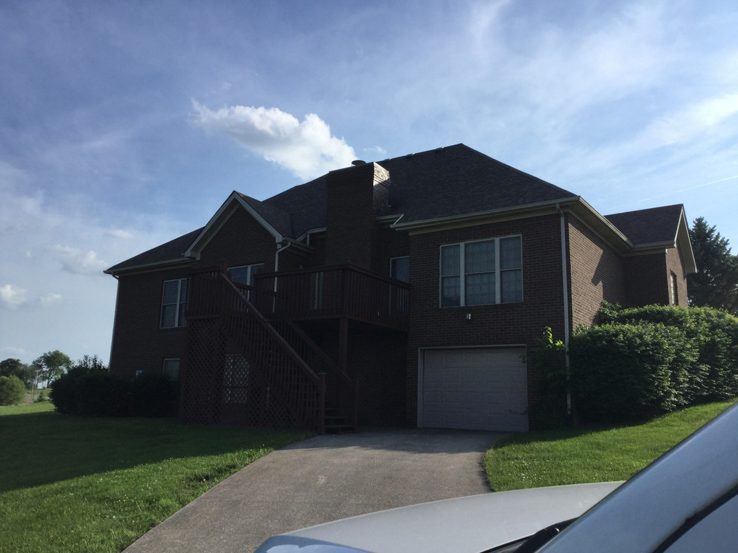

No sump pumps. I’m assuming there are foundation drains all around the perimeter but I’m not absolutely sure. The way my property lays it drains really good.
Water doesn’t stand a chance in my backyard with the slope and storm drains just below my driveway.

For cleaning the greasy wall, the first thing I would consider is a TSP solution.  I'm not an expert, but found this article might be a good starting point:

TSP, followed by white pigmented shellac primer.
lot's of fresh air while in use

Great minds must think alike! I used the shellac based primer sealer on the walls I just painted and it did a great job, although they weren’t as grimy as the remaining walls that need cleaning and painting. I will have to get some more though, I used about 1/2 gallon from a can I had for years. I never throw anything out! I was glad to see the empty can go in the trash though.

Yes, it looks like you're on a pretty big hill, so groundwater level probably never gets to 18" like at my house (region).

Yep, I live on some pretty high ground. It’s hills and hollors around here. It’s only about 5 miles to the Kentucky River so just about everything drains that direction. I imagine I’m close to 500 feet in elevation from the river too.
