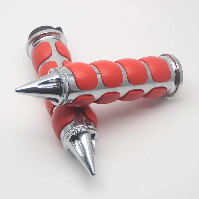

« Reply #52 on: July 28, 2020, 08:42:45 AM »
I'm liking the black, but I'd take the shine clean out of it and go for a matte similar to the carb covers.  Going with Gordon's idea, I'd consider running that continuous stripe (as seen on that blue and white paint scheme) right down the middle all the way from fender to fender -- except maybe a bit narrower and in red.
Maybe dark smoke flasher lenses up front. https://www.ebay.com/itm/Smoke-Turn-Signal-Lens-Lenses-Indicator-Blinkers-For-Honda-Valkyrie-1997-2000/153216484511?hash=item23ac6a049f:g:70oAAOSwQG9d-msV
Then toss a set of these on as the icing on the cake!  https://www.ebay.com/itm/291487184381
Or maybe even better these!  https://www.ebay.com/itm/Motorcycle-Red-1-25mm-Rubber-Handlebar-Hand-Grips-Cafe-Racer-Bobber-Bike-Custom/282597895720?hash=item41cc25ae28:g:HwAAAOSwyYFaHNIs&redirect=mobile
Gotta admit that blacked out bottom picture looks pretty radical as well.
Awesome so far...   cooldude
