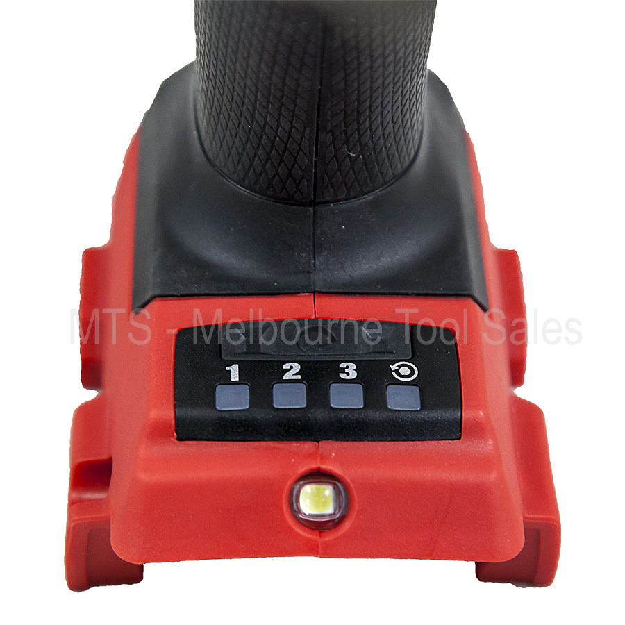

I recently bought the Milwaukee 2767, with "1,000 ft-lbs of fastening torque and 1400 ft-lbs of nut-busting torque."  One nice feature is the setting has it go full power until the nut is broken free, then immediately slows down to a reasonable speed to finish removing the nut.  I love it, and haven't found anything it won't loosen.  I got mine locally at a good sale for CAD$250, without battery or charger.

« Reply #15 on: June 04, 2020, 10:33:45 AM »
Thanks for posting that GR.  I thought from your post Milwaukee had released a bigger impact driver.  Turns out that's the P/N of mine.  Milwaukee rates the power higher than the site I got the power quote from.  Nice to know it's 1400 & 1000 ft/lbs.  I didn't notice it slows down when spinning out the bolts.
For that feature, push the button on the base, just above the battery, until the fourth light is on.
