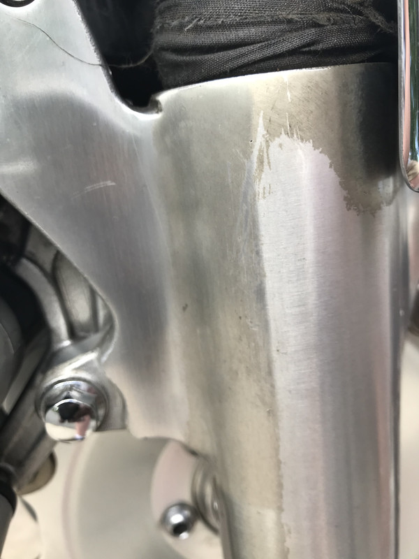

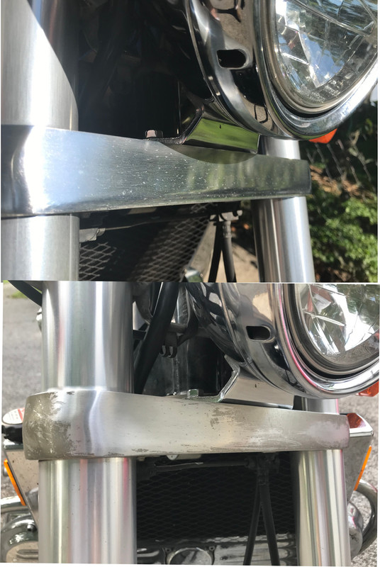

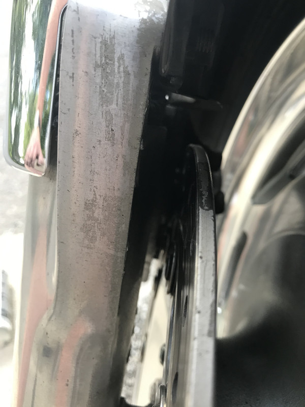

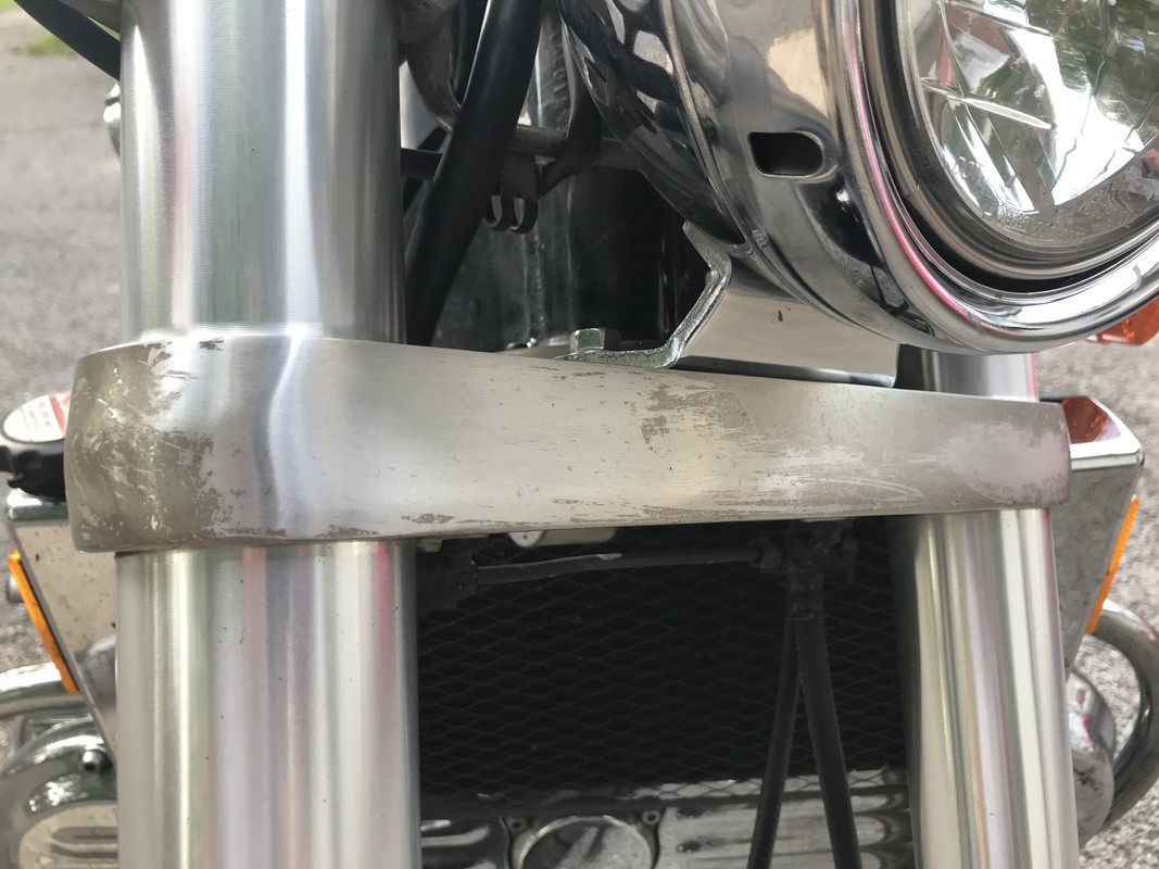

I finally started a long overdue cleaning and polishing. I assume I am not first to encounter this problem on a 20 year old motorcycle. I also assume this is the original finish flaking away, not some sort of gunk build-up? But, I could be wrong. (2001 Standard.)

         While I'm NOT sure thinkin it was a clear coat. On my 99 I/S the fork lowers were lookin a tad shabby. Took some 400 grit sand paper and scuffed it off-the clear coat. Some california purple metal polish and some elbow grease the fork lowers came out lookin better than when I started-If I duz say so myself!  Roll Eyes RIDE SAFE.
Posts: 5464
« Reply #2 on: August 21, 2020, 06:13:25 PM »
I’ve polished several sets of fork lowers. I start with oven cleaner to remove the OEM sealer. Wash off and then use wet n dry sandpaper. Start with maybe 400-600. Move up to 800 and finish with 1200. Then go to metal polish and a buffing wheel on a drill motor. Before starting, remove the wheel and fender.
Posts: 14934
« Reply #3 on: August 21, 2020, 06:15:54 PM »
Just polish it off with elbow grease and aluminum polish. It’s easy

But it is an OEM clear coat or finish, correct?

I don't think so. I think my '01 Standard only has the clearcoat on the wheels and pumpkin. It looks like a thin amount of oxidation to me. I think Jeff is right. It should clean up well with some aluminum polish.

Yes, definitely OEM clear on the triple tree and lower forks

Yep.  OEM.  Same on my 98.  You can polish it as many have said or use soap and an sos pad to just clean it up.

I used some 600 grit wet sand paper, then rubbing compound, then Mother's aluminum polish. Far from perfect, but better than it was yesterday. I did nothing to the lower forks at this time--those will have to wait. Thanks to everyone for your advice.
