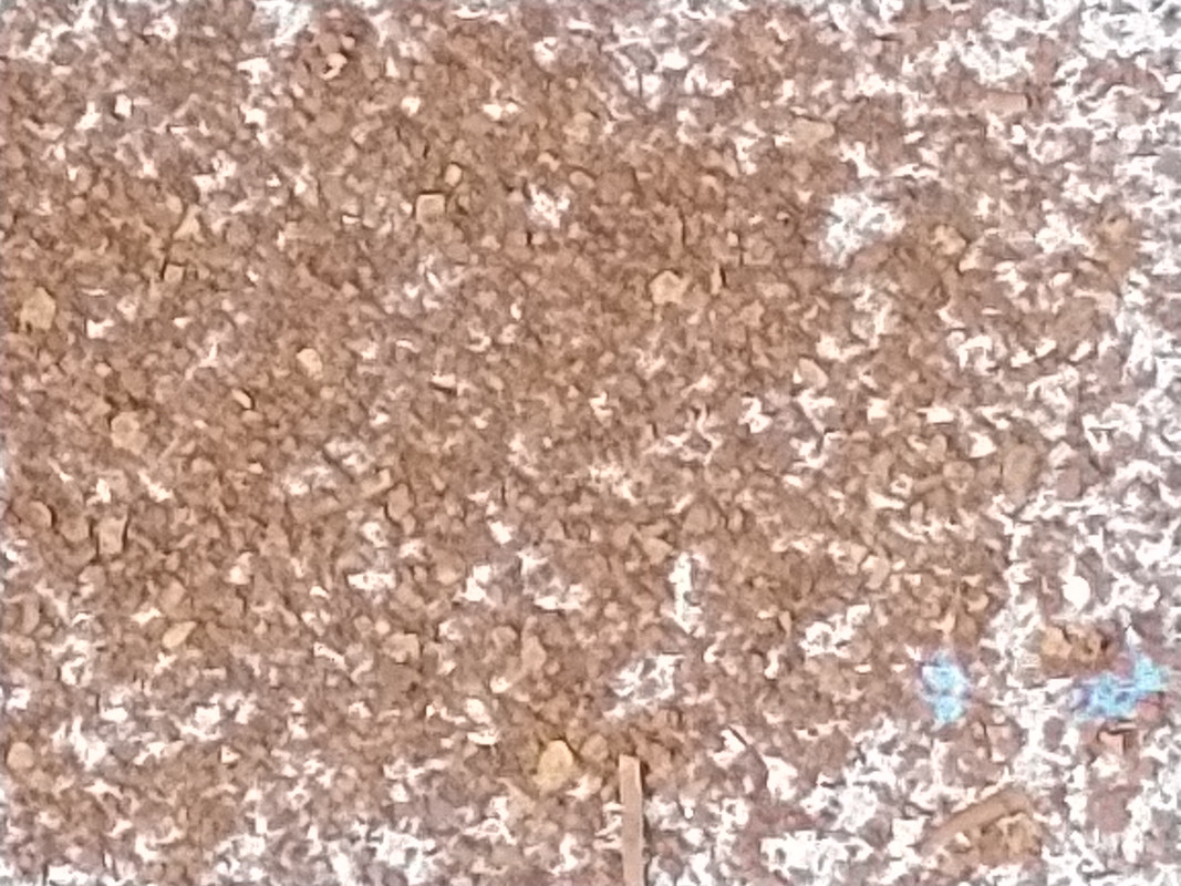

Today I spent some time on the Valk.  I got the gas tank off and discovered . . . it was empty.  Assuming you don't count all the rust I shook out of it as contents. The picture is a small sample of what came out.  I didn't think to shake it over the concrete until I'd gotten more than that out.
I'm thinking some of that is rust from the tank walls and some is just the dried out gas.

Now I have to pick my poison concerning how I'm going to clean the tank.  I was thinking I'd use vinegar but seeing how hard it is to get the rust out I need to find a way to dissolve it so I can rinse it out.
Wow that's surprising your seeing that much rust & debris in the petcock and elsewhere.  Any chance that bike was in a flood?
If you haven't seen this already this guy has some good tips on cleaning & repairing the fuel system from the tank to the carbs.  I think it's like 7 or 8 videos in the series.
