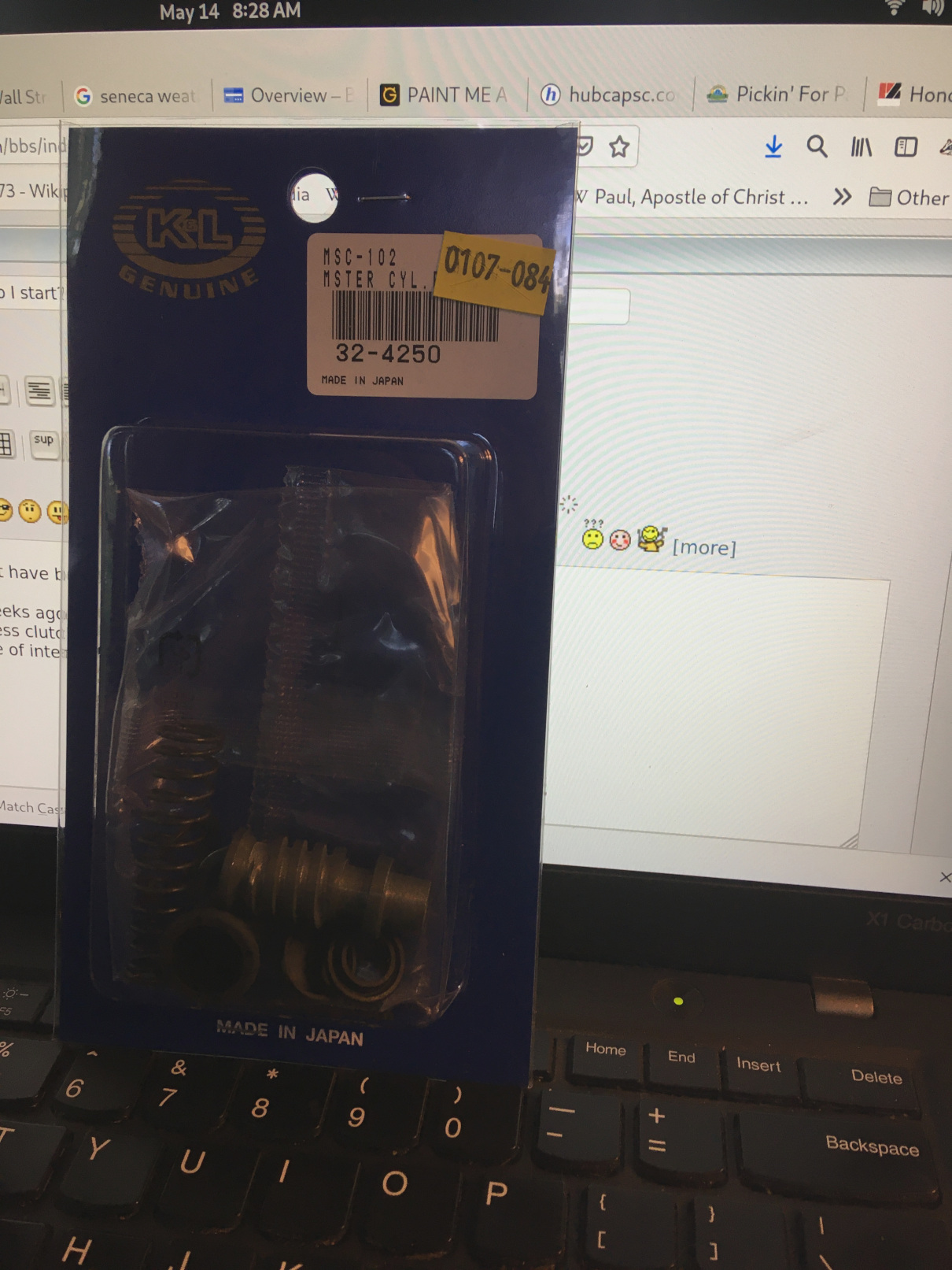

I bought this K&L rebuild kit. I avoid aftermarket parts. This thing
looks OK, and I was happy to see that it is made in Japan as
opposed to some other places. Has anyone used any K&L
Japanese parts?

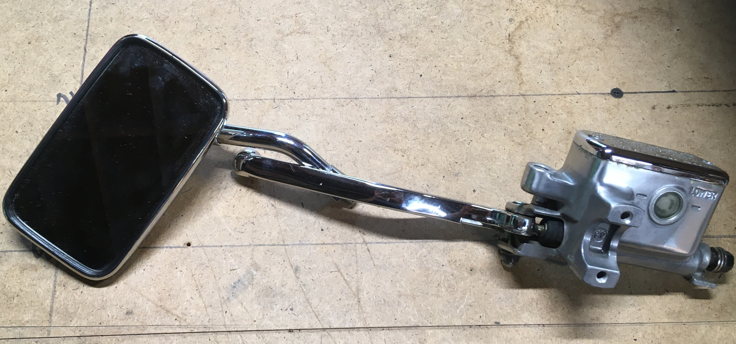

« Reply #6 on: May 14, 2021, 08:21:08 AM »
Since some stuff is getting harder to get, when my clutch
hydraulics went south I looked all around... besides the
K&L master cylinder rebuild kit, I looked on ebay and
found this for $75...
Hydraulics don't work on "looks", but it looks pretty darn
good. The little rubber cover that's exposed to the world makes
me hope the important rubber parts inside are good too:

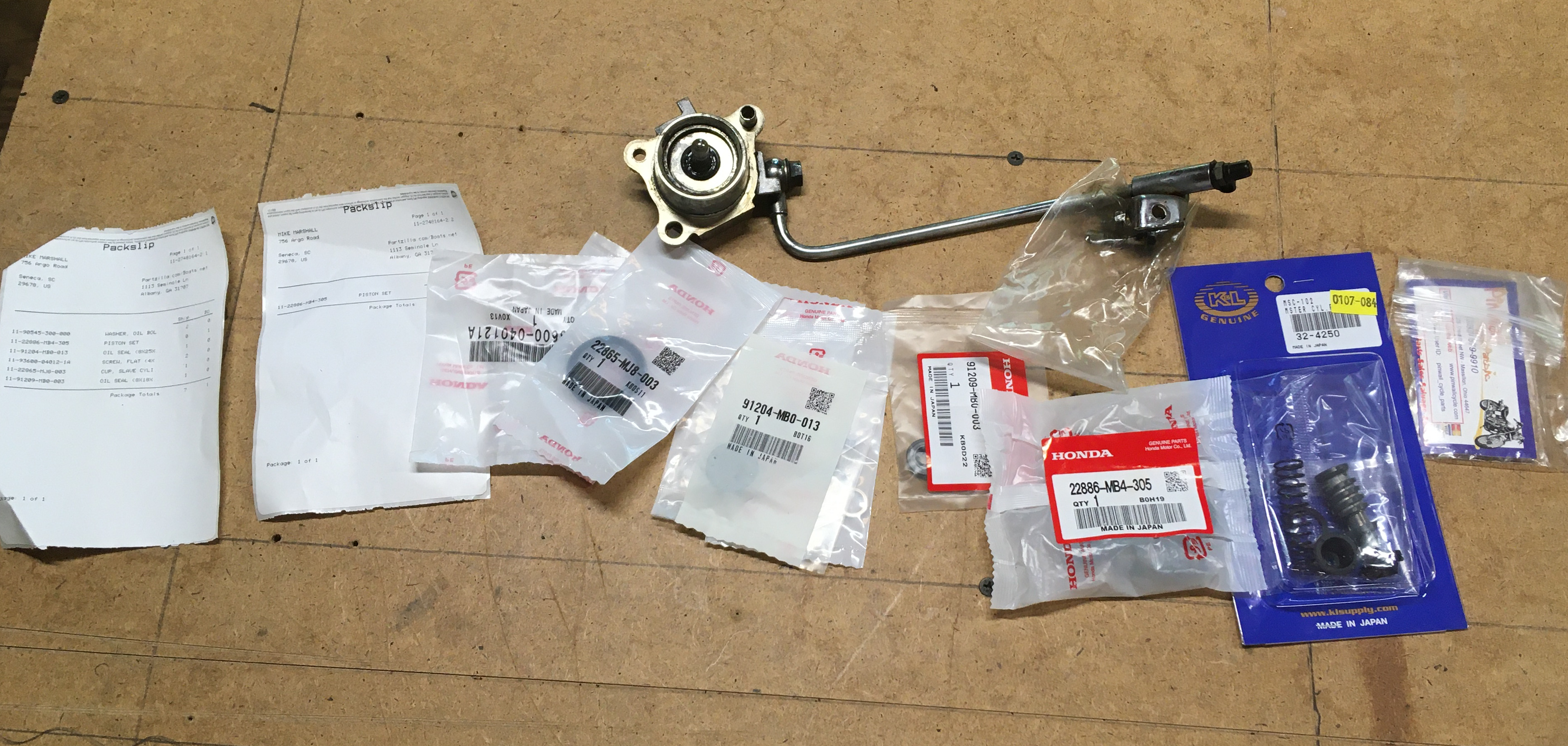

Posts: 16804
« Reply #10 on: May 14, 2021, 08:01:30 PM »
If you already got a whole new slave cylinder, you don't
need most of these parts, just 22886-MB4-305
to rebuild your master cylinder. Those screws I got
are for the master cylinder cover, I don't remember
why I got them, I think it was because they are so
cheap they need to be bought with a larger order
to keep from having to pay so much for shipping them.
They are not phillips screws, but JIS screws. The right
screw driver came in the Valkyrie tool kit - a regular
phillips screw driver will eat them up.
Those two washers are the crush washers for where
the bleed pipe connects to the slave cylinder body.

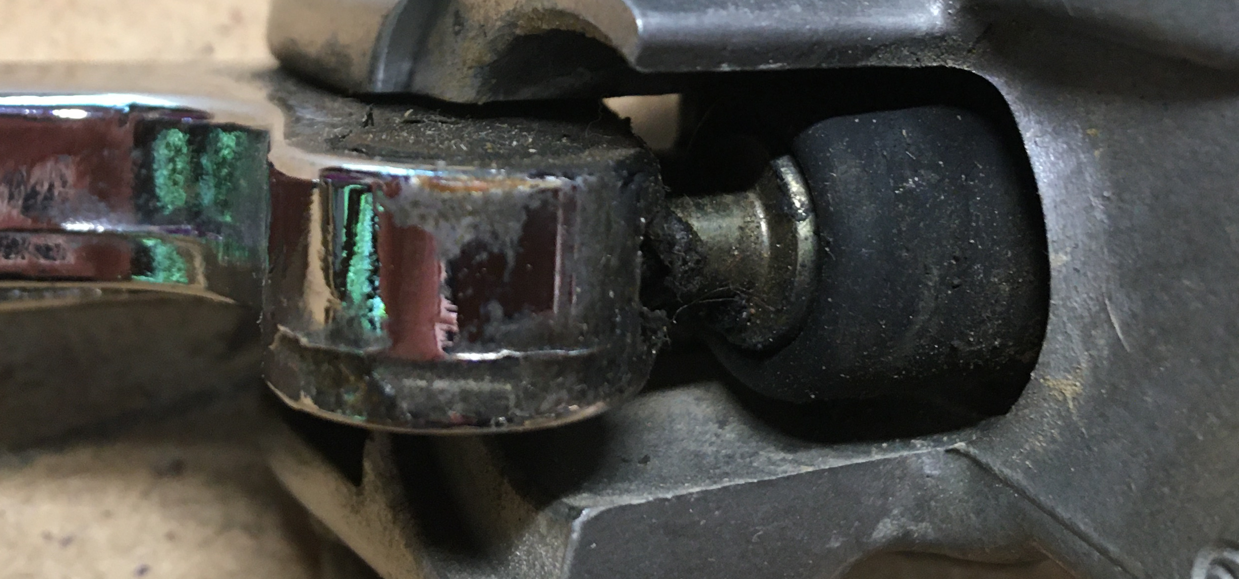

Anywho... it was hard to get the slave cylinder off... the leakage
certainly melted the paint on my engine down there...

cylinder it stuck in the piston instead of sticking in the clutch
so I have it... 16 is a lot shorter than 15... obviously some bikes
have the short one... I checked four or five other year's/bikes fiche
pages for the clutch, none had the short one... I wonder what
Valkyrie uses the short one?
