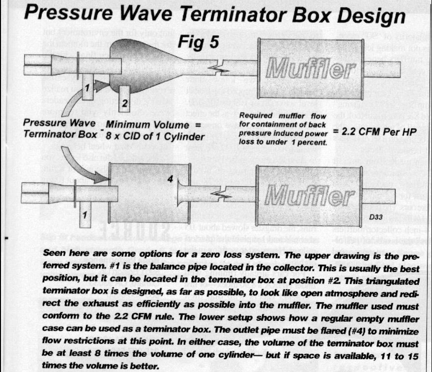

see image of Terminator Box, which is the basis of the Viking Exhaust system.
Having a glass pack design exhaust whereas the glass pack is basically attached to the header collector is not the best system to use. The TwoBrothers 6x2 exhaust system is a glass pack system.
a pure race track setup, dyno testing shows a straight pipe connected to the collector in the correct length is slightly better than the Terminator baox design.
for street use TB design is best.
http://i292.photobucket.com/albums/mm11/Belgiquebasterd/file-4.jpg
