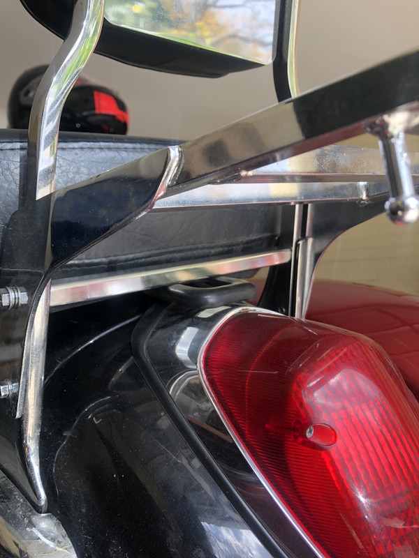

Soo. I got some 304 SS 1/2” square tube
Welded in a M6 connector nut ( long nut ) to each end inserted and welded
Pop riveted on a little Teflon strip to the under side
I cant seem to load a photo
But now that it is polished it looks like part of the sissy bar rack 1

« Reply #8 on: October 15, 2021, 08:56:55 PM »
Here goes images .,.,
The end result
I took a skim of the corners of the long nuts in the image  and pressed them in to the square tube,
Had a mate weld them in and i polished the tube by hand
Test pice and hardware for construction, ( under 10 bucks )
Loving the finished look of the bike
