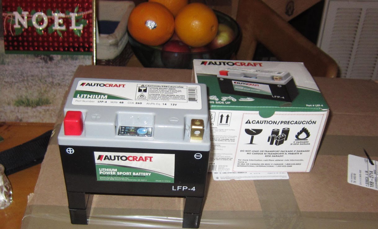

A Valkyrie has a large alternator... like a car... I have BigBF
Quad Horns, heated gear, Moto Lights and a Cobra lightbar.
If your Valkyrie's alternator and stuff is in good shape you
should be able to add a reasonable amount of accessories
without a problem.
A universally liked Valkyrie battery is a Yuasa Battery...
YTX14-BS I think.
I've had this battery since 2014, it still seems good.
Louis

I too have one of those Autocraft batteries. I couldn't find much info about it on-line, like who sells them or what they cost. It came with the new to me Valkyrie I bought back in March. Seems to work OK. My atv's all have Yuasa batteries that last a long time. Just replaced one this fall that was 10 years old.
