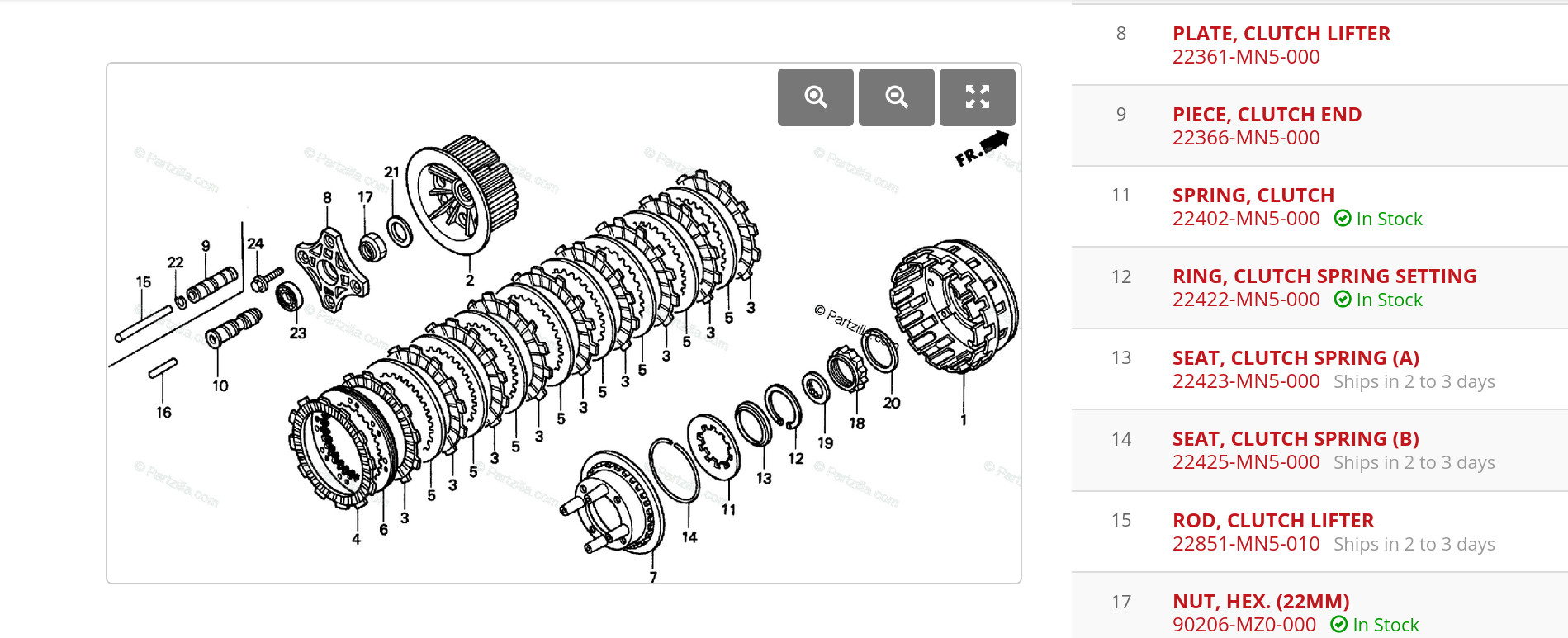

Here's a cut-and-paste from a post I made then...
Checkout this fiche picture for a 97 clutch, some bikes apparently
have 15 (mine), some have 16. When they pulled the ebay slave
cylinder it stuck in the piston instead of sticking in the clutch
so I have it... 16 is a lot shorter than 15... obviously some bikes
have the short one... I checked four or five other year's/bikes fiche
pages for the clutch, none had the short one... I wonder what
Valkyrie uses the short one?

« Reply #3 on: December 18, 2021, 07:15:04 AM »
Were parts 16 and 10 available at one time.
Avanti
Posts: 1410
Stoughton, Wisconsin
« Reply #4 on: December 18, 2021, 07:33:58 AM »
Looks like 10 and 16 are listed for 97 only. The parts picture shows 9 with 15 and 10 with 16 for all years but only lists 10 and 16 for 97 although no longer available.

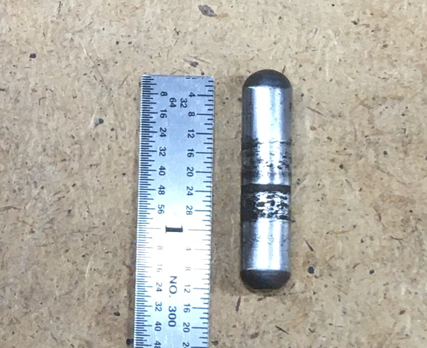

This is the short one that came with my pinwall slave cylinder...
I have a 97. It has the long push rod...

« Reply #9 on: December 19, 2021, 09:16:00 AM »
And this is what is in my 97, obviously the long one.
