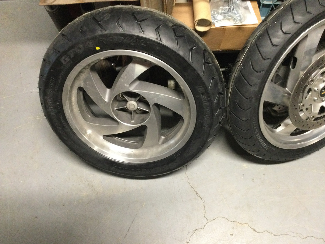

Anybody using them? I decided to try them with some fresh rubber I had mounted this week.
Nobody locally had any, so I had to order some from NAPA and are supposed to be here this morning. Honda shop who mounted the tires, offered to break the tire back away from the rim so I don’t have to run the beads thru the valve stem and do it with no additional charge. The beads I ordered from NAPA didn’t come with any application tubes, bottles ect so I’m taking them up on their offer.

Well this time it turned out to o be heads for this tire set. BB’s wouldn’t go through the valve stem and I didn’t want to break down the tire from the rim to get then in there. The beads were contrary too but I finally got them in. I’ll just have to deal with a puff of air in the valve stem before checking tire pressure.
