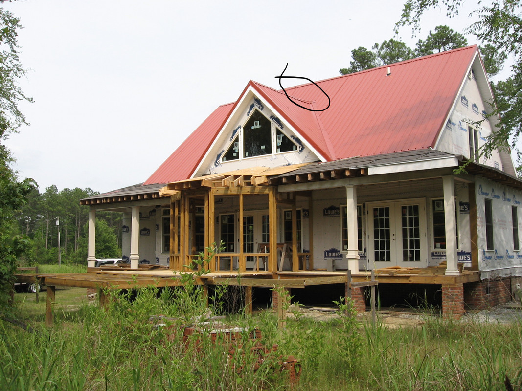

Where in this picture is the mold?
Like Jess stated, wind driven rain will travel up hill.  Water could be driven up under the ridge cap and under the roofing.  The underlayment should weep it down to the eave, unless it hits a tear or improperly installed staple/nail.
If it's discovered to be a exterior leak, the type of roofing you have can be very easily removed.  You could do that dormer side in about an hour.
I have circled it (well sort of) in the image below.
Understood
You know that is right, the hard part would be getting up there (I am gettin old).  When the guy came out from the roofers shop, he must have had special boots on but he did climb up there, look at the peak and said, while there was some caulk that was cracking, he did not believe it was leaking.  He did apply some more calk.
Therefore, I would contact them again for help.  I did not get a bill for him coming out.  We will portably send them a check for $50 for making the trip (it was only about five miles) and the 30 minutes he spent here.   Just because he did what he did.

I tried a closer look at the photos you posted on page 1.
I tried to zoom in on the before the metal roofing was installed, when it was just the underlayment with the tin tabs hold everything down. My focus was at the peak where the ridge joins the valley.
The only thing I noticed there (but not too clearly) was it looks like there is a seam right in that area but I could just be the angle the photo was taken.
There’s plenty of overlap covering the valley, it just looks like the row above the dormer ridge comes right to the edge of the ridge and the tarpaper (underlayment) covering the ridge doesn’t go up and under that row above it. So if there was wind blown rain that could be your culprit.
And that was my thought as well because the mold did appear after a really strong rain storm with some heavy winds.

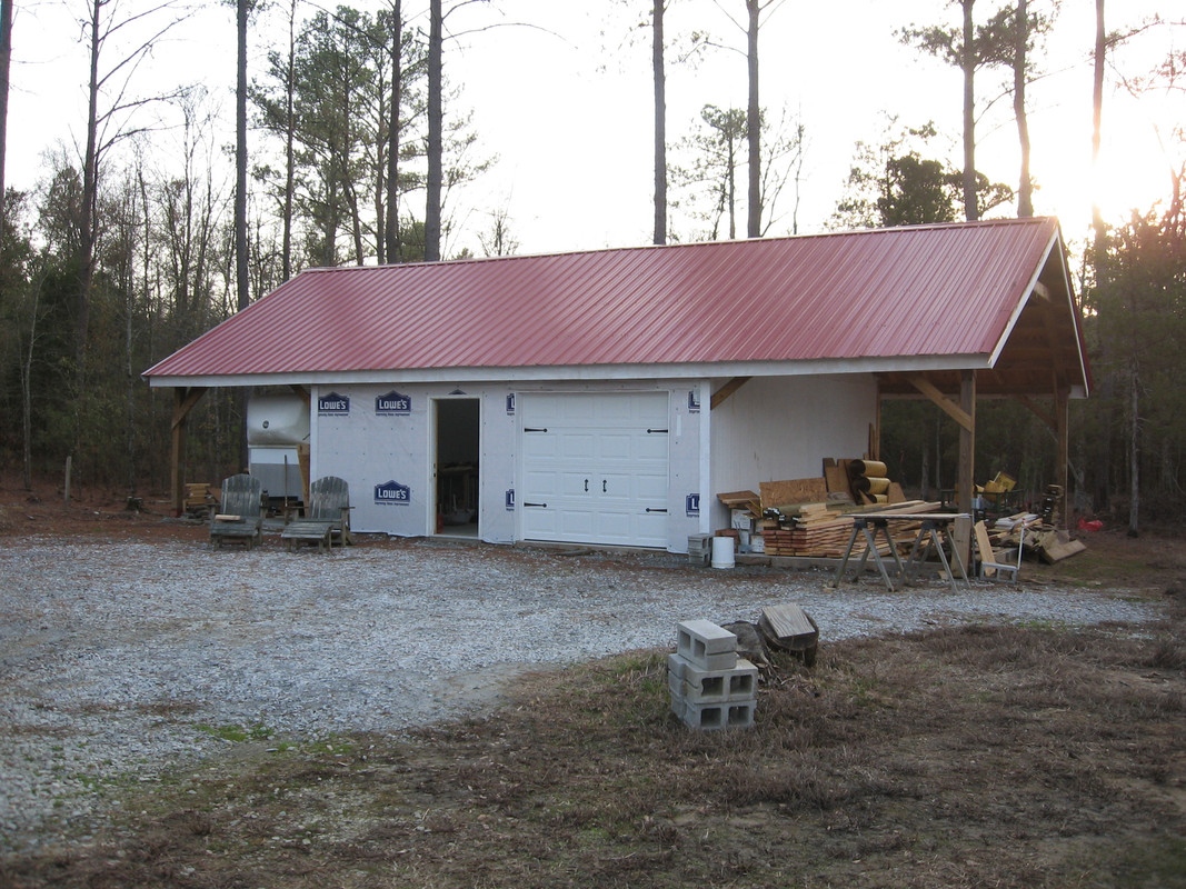

This is an image of the garage and its metal roof (before the fiberboard siding was applied.
