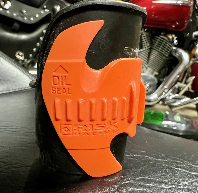

f-Stop
Posts: 1818
'98 Standard named Hildr
Driftwood, Texas
« Reply #5 on: June 14, 2023, 05:16:25 AM »
I think a "seal doctor" is one of these...
Got it for the dirt bikes, but have used it on the street bikes.  It won't fix old seals or worn bushings, but works great to clear gunk or dirt from a good seal (which will cause leakage) and can save a lot of $$ or time.   cooldude
