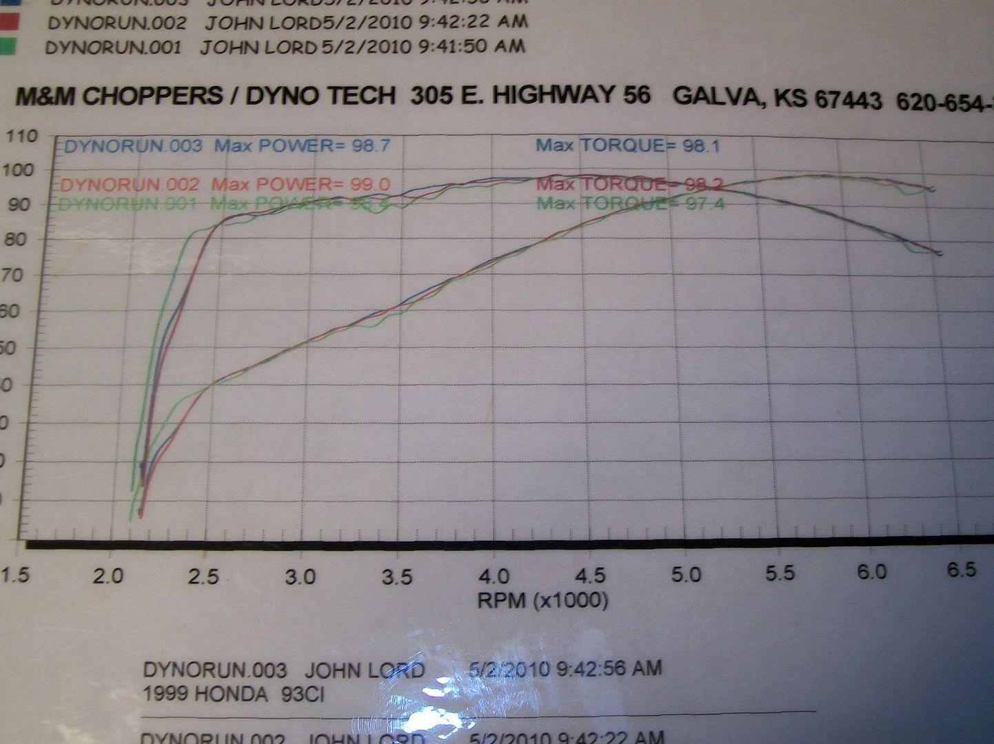

I don't understand why everyone keeps talking about a loss of performance with the Cobras. If you jet the bike properly to match then you'll actually improve performance a little bit.
Put it on a dyno and you'll see why people talk about loss of performance.  Wink
I've seen guys quite shaken up by the results ... especially after seeing the dyno results of "another Valk" with the "glass pack" mod. Smiley
It has been on a dyno, it GAINED horsepower with the Cobra 6X6 and re-jetting. Not a lot but it was about two and a half horses up top but stayed pretty much flat everywhere else.
MP
I would LOVE to see the results (before and after) because, at Inzane in 2003 (and also a few times at Americade), I have witmessed many Valks on the dyno (one after the other).
EVERY Valk with Cabra 6 X 6 was at least 10 HP weaker than the stock OEM Valks ... and when compared to the ones with glasspacks (Mark T, DIY ones, etc), it was even worst.  Smiley
Having said that, I know how these Cobras function .... 'cause I've been there ... had them on my Valk.... but took them off and never looked back.
A Valk with Cobras but without needles, etc. will lose HP. Add the needle jets and it will gain a bit on what it has lost but ... it will never be up to par with an OEM set up.
Sorry ... have seen too many.
I do not wish to start arguing. The above is a witnessed fact.
I like the sound of the Cobra 6 X 6 but ... hate the power loss.
This is the end of my Canadian 2 cents.  Cool
I still have a full deck.
I just shuffle slower ...
I don't doubt that if you just slapped a set of 6X6's on there that you'd lose power, probably a lot actually. They come too lean as it is and you're only going to make it worse with a freer flowing exhaust. From what I understand re-jetting alone can net you a little power in some instances.
But I ride with another Valk that's got modded stock pipes (cut piggies) and I run right with him. There's now way I'm 10 horses down.  2funny And there's no way I'm down ANYTHING to the bone stock bike I rode the other day.

« Reply #58 on: August 23, 2011, 12:35:36 PM »
http://www.valkyrieforum.com/forum/tech_archive.cgi?read=969520
This was posted by J. Orr, 3/27/1998, on the GWRRA BBS, valkyrie section.
The following mods were done by Marc the owner of Factory Pro of a valkyrie that had cobra 6x6 pipes.
K&N filter (w/o prefilter)
Air box mod (remove plastic welded baffle)
38 pilot jet
3.5 turns idle mixture screw
front needles set on #3
mid and rear needles set on #2
115 main jets all carbs
this picked up 5 hp over the base run with the cobras which are down about 10 hp from stock.
this HP is still down from the stock pipes
I talked to Marc when I was jetting my bike w/glass pac mod about the cobras and the testing on the above bike he did, he said, "u can only get back to stock oem HP, anymore and major jetting and air inlet changes need to be done but mpg will go down." more or less his words.
drag pipes aka as straight pipes which the cobras are, came about from the HD dirt track racing program. they will make more power but only in a very narrow HP range such as used on a circle track. anything else and they are terrible for HP compared to other exhaust designs.
Did the pipes have the baffles in?
yes, as they came from Cobra, I was told, by Marc.
The Anvil
Posts: 5291
Derry, NH
« Reply #61 on: August 23, 2011, 12:51:38 PM »
38 pilot jet

That statement surprises me because ... past dyno tests have shown that TRB 6 into 6 pipes produced MORE HPs than Cobra 6 X 6 pipes.
Compared to what? Did you have it tested on a dyno?

Butt dynos suck, if you wanna know, spend the 30 bucks.  Hoser

Butt dynos suck
I've gotta disagree. If you get to know a bike well enough then you can develop an innate sense of the power it's making and the effect that modifications have. Not everyone possesses that ability though.

Butt dynos suck
That is a pretty odd statement.  If you want to "guess" at the HP okay.  But if you are actually trying to convince someone who knows what they are  talking about, good luck, you are going to get laughed at a lot. "It feels (sounds) more powerful therefore it  is more powerful". They would ask to see the calibration certificate for your butt.
     My experience with dynos is that there will be some variation anyway.  Mine went from about 96 hp on the first run to 101 on the third.  This is max HP.  How many of us ever run these beasts at the max?  I was more interested in what it was making and the fuel/air ratio at 3K than I was at 6.5K.  By the way this a stock setup '99 IS with a K&N  with pre filter.

Butt dynos suck
Well like I said, you can't put it on a graph. I'm not talking fine points here, I'm talking about developing that intimate connection between yourself and the machine that allows you to feel power differences from modifications or environmental changes (like on a hot day vs. a cool one).
But lemme put it to you like this; my buddy Rich has a 99 Valk with modified stock pipes (cut piglets, outer baffles drilled) and he can't outrun me. I'm also about 80lbs heavier than he is. So my "butt dyno" tells me that I'm not down 10 horsepower to his bike.

Back in the old days.  I had a Suzuki X6 Hustler.  250cc 6 speed 2 stroke.  A buddy had a 500cc Kaw. triple.  We used to do stop light to stop light a lot.  He never came close to beating me.  I mean not even close.  He couldn't figure out how my bike could out accellerate his bike.  It was not my BIKE that was out running him.
   So I would put it to you this way.  Is your bike staying even with his or are you staying even with him?  Do you shift at exactly the same times and RPMs?  Does he hold the clutch a split second longer than you?  Does he run over the top of the curve and start losing power?  Are you trying harder than he is?  I believe those things are more important than a couple of horse power at 6500 rpms.
   I saw on my dyno runs that after 6500 the horse power dropped by about 6 or so before it hit the limiter.
Well Rich knows how to ride. He's pulled some impressive drag strip times on his Valk (and he's owned it since new). I don't think it's that we're far apart in ability. We've both had time at the strip in fact. I attribute his not being able to take advantage of his lighter weight to his shield and Air Wings adding resistance.

So you are not really riding equal bikes.  His has the extra resistance which could very well eat up the extra 2 or 3 hP he is putting out , since he probably already lost some by messing with his stock exhaust.  See where this butt dyno gets you?  Plus  dyno horse power does not neccessarily translate into acceleration which is what your butt dyno is recording.  If I ran a real world run on my bike (160# with boots) without bags , trunk, pods, or shield,  then another one with a big fat fellow and all of the geegaws attached.  I can pretty well predict that even with the same hp the times are going to be different.
