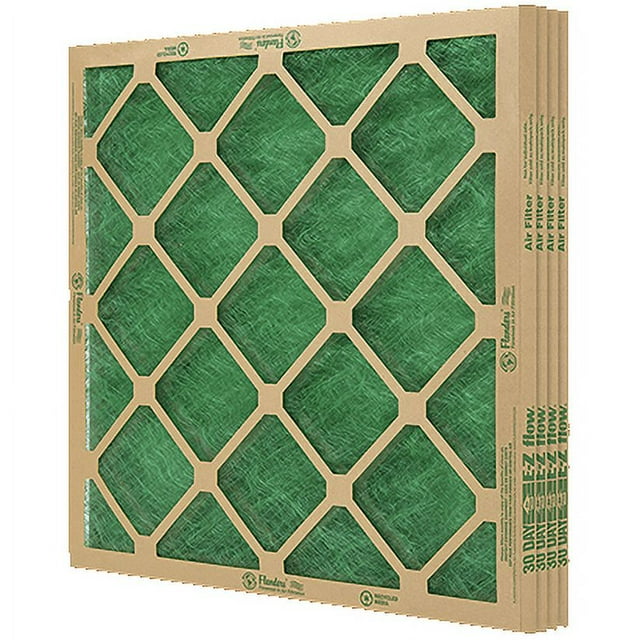

Jim, they are called AAF Flanders Nested Glass MERV 1 Air filters (at least on Amazon)
And you'll obviously have to get your correct size.
Notice they say 30 day right on them.

Well my free flow 30-day green glass filters arrived from Amazon yesterday.
24 of them fit in a box only 10 1/2 inches wide (man are they skinny).
I've put up a bold sign on the furnace I (hopefully) can't miss to put one in the 1st of every month.
I'll be interested to see what they look like after 30 days.
