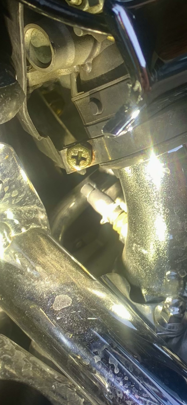

She’s more of an ornament than a helper.  Cheesy. Still working on pics.  Here is one of the hose missing.
Are carbs numbered a certain way?  It’s the middle carb on the right side of your sitting on the bike. It only seems to leak once per riding session in a very small amount of say a few drops and drips from what looks like the carb itself.

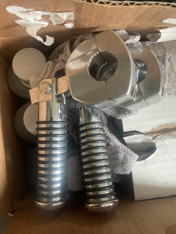

I also have some cruise pegs and fender trim for sale if anyone is interested.  I don’t use cruise pegs and I bought the fender guard before I realized I would have to drill a hole in the fender to install it…won’t be doing that. It would look nice however.

Seems you have the numbering down right.  Sitting on the bike, right front is 1, left front 2, right middle 3, left middle 4, right rear 5, left rear 6.  Looks like the hose you're missing is the vacuum line....if you're trying to show the cap in the photo.  Indicates your bike has been desmogged.  Should only have a vacuum line on number 6, left rear carb.  This will go to your petcock unless it's been changed to pingle or other non vacuum type petcock.
Interested in your items, send me a message.  Thanks

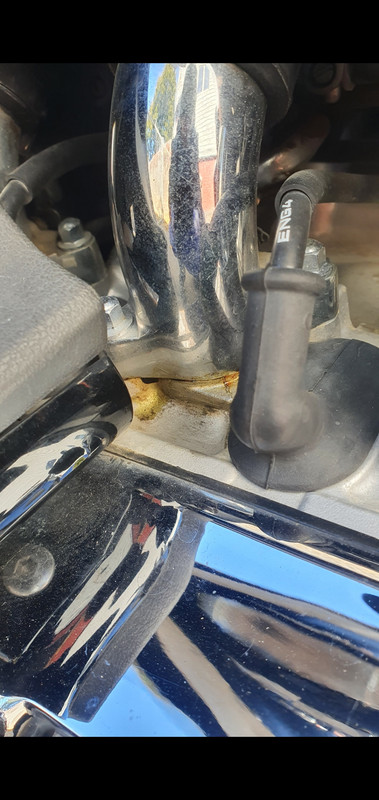

Ok… so I went out and did some more checking by just letting it idle and taking a good look. It appears I have a leak coming from the fuel rail directly behind carb number three. This is quite disappointing as I have just bought the bike a couple months ago and it seemed fine on the two hour ride home.

The stubby black rubber thing in the top picture is a Honda vacuum cap.  With the engine guard in the picture, it indicates we are at cylinder #2. This is the way Honda made it.  Nothing modified.

“The stubby black rubber thing in the top picture is a Honda vacuum cap.  With the engine guard in the picture, it indicates we are at cylinder #2. This is the way Honda made it.  Nothing modified.”
   Gotcha, so after looking again it is “capped” at numbers  1,2,5 with hose connected to 3,4,6.
Your motorcycle is correct. That's how Honda built it.

Still leaking a few drops every few minutes up behind or including carb #3. Looks like I’m gonna have to try to get the carb rack out and send it off for a rebuild.  Just need to find a close storage where I can start on it.

Seems like it doesn’t leak once I’ve gone somewhere and head home. In other words when I get somewhere and look, there’s a few drops, if I wipe them dry when I get home, it seems to be dry.
Weird…

I’m no expert, I don’t think there is anything wrong with the through bolts. I just stripped the nut. I know one of the members mentioned making sure they were tight……….I gave it a shot. It didn’t work. So if anyone else tries to snug them up in hopes a leak will stop just don’t overdo it as Mooski mentioned they are only 7 foot pounds.
   I just want to replace the nut now and limp my way into October before I attempt to pull the carb rack myself and have it refurbished. I am certainly no mechanic and just pulling the carb rack will be at the edge of my abilities. I’m sure I will continue to watch some YouTube videos on the removal process.
I'm not a mechanic by trade but I am mechanically inclined. You can definitely get the carbs out on your own, don't follow the service manual though. Use this PDF, I take no credit for this, this is from Dave at https://www.valkyrieflatsix.com/.
https://jumpshare.com/s/HzwAoHVhxOcwgIUjDkZB
I uploaded some videos on YouTube on rebuilding the carbs after I cleaned them in an ultrasonic cleaner. It's a meticulous job but I wouldn't say it's something only a mechanic can do. If you someone who could build a model or something similar it's definitely doable, I took mine off, set them up on a table in a room and rebuilt one at a time and I was good to go by the time spring came.
Disassembly
https://youtu.be/tx3AnNUVahI?si=XBHIoFeG6k_xUruP
Reassembly
https://youtu.be/qiY2pCfTwMw?si=p2qMvrZV13vTg7QI

“ I had a leak on # 3 several years ago. Tried tighting the through bolts which was fruitless.  Seperated carbs just enogh to remove the tube and replace packing. Did not remove carb bank. Took an hour and no more leak.”   I sure wish I could do that. How did you manage to do that Challenger?
