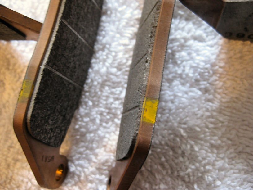

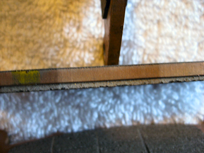

...you're not supposed to mix OEM brake pads/rotors with EBC rotors/pads.
These pictures are brake pads put on the bike, new, one month ago when I changed the rotors.  They are Honda OEM and the rotors are EBC.  Less than 1000 miles and they are 80% used up.  Apparently the EBC rotors are hard stuff.
This leads to the conclusion that if you put EBC pads on with the stock rotors, you'll chew up your OEM rotors.  Somewhere in the past I'm pretty sure I did just that which is why I now think my rotors wore out prematurely.
The above comments relate to sintered pads, not organics.

« Reply #1 on: March 07, 2010, 05:53:41 AM »
as you said, maybe that is the reason.  They are designed to match up oem and oem and aftermarket to aftermarket.

Ricky-D,
I know you're a proponent of organic pads, but from everything I've read, they only achieve full stopping power after they heat up.  Now, this may only take a few tenths of a second to achieve, but for how and where I ride (the DFW Metroplex) I want those few tenths on my side of the stopping equation.
I'd rather spend extra on sintered pads when they wear, and on new rotors once every 50k miles than give up the advantage, however small.  And, now that I know WHY you match pad and rotor manufacturers, I may not have to replace my rotors again.
