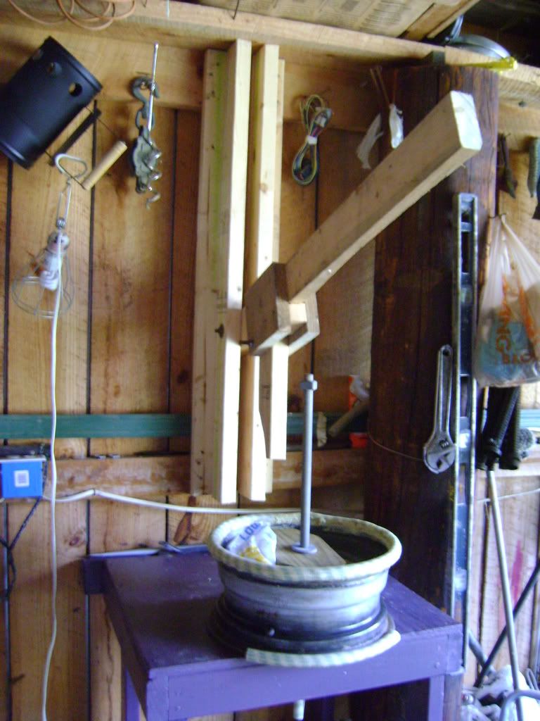

« Reply #3 on: March 07, 2010, 05:40:27 AM »
Go to a junk yard and get a 14 inch rim alittle garden hose around the top and you're in business. I've got maybe $30.00 in it thats counting two new tire tools ( spoons ) from Northern Equipment.
