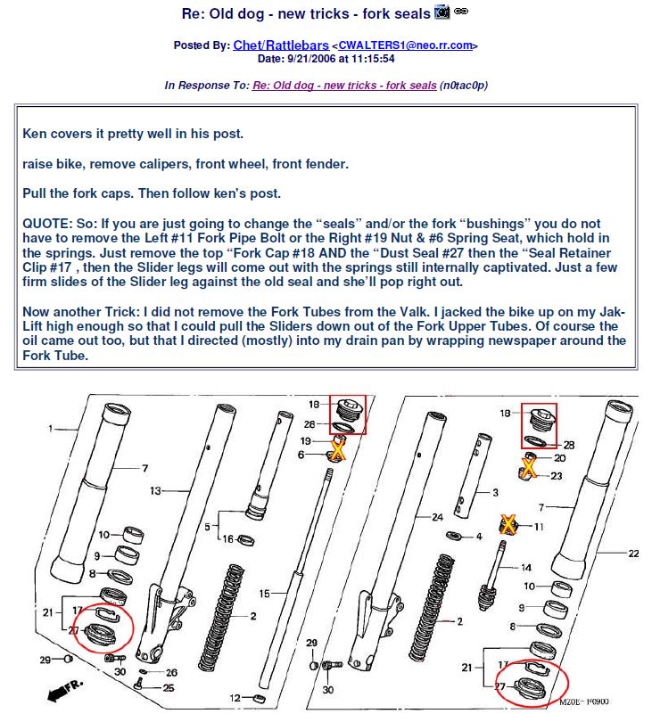

I got a lot of requests to mail out the PDF where Chet describes the easy way to change fork seals.  I know I missed a few people so I've posted a link to the file so everyone can get it.  Here it is:
http://f6dave.dchealy.com/fork-seal-change.pdf

That post describing the easy method to change fork seals is still very popular!  I kept the PDF of it, and placed it here: http://dchealy.com/valk/fork-seal-change.pdf

I did my fork seals using the instructions on the first page of this topic. Was not a bad job at all. I am glad I did. Even though I had got the seals to quit leaking there was alot less oil in them. It feels like a new motorcycle now. not as much front end dive when braking.

Watch this video it's in four parts.
VTX 1800 Fork Seals Part 1.wmvpowered by Aeva

Screenshot of the 17 year old post:
