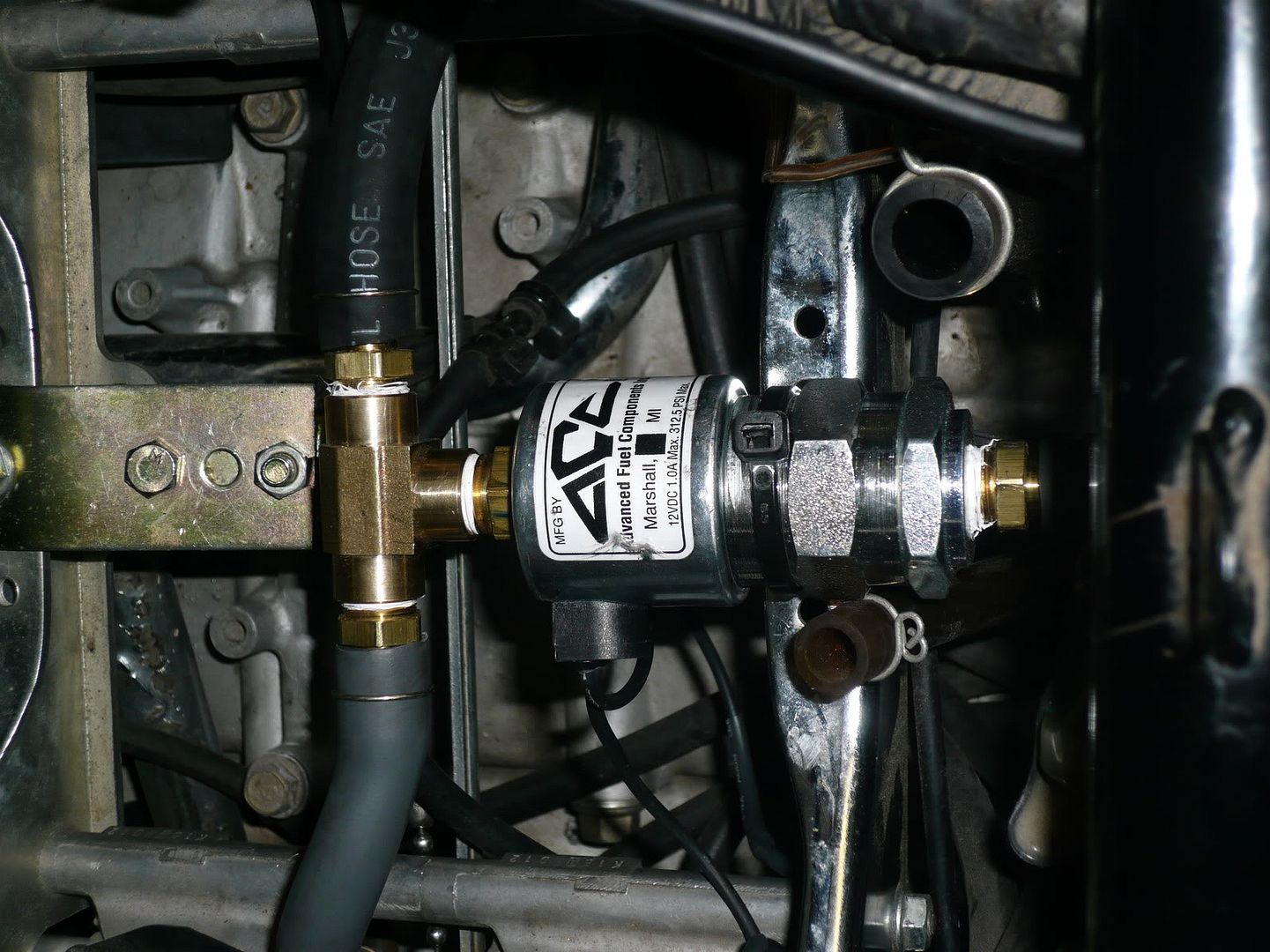

I initially wired my solenoid valve to a nearby ignition coil supply wire. Bad idea.  uglystupid2 Don't do it. The Dan Marc solenoid only draws 1.25 amps but the ignition coil need every bit of voltage/current it can get to avoid a high speed miss under acceleration. I rewired my solenoid to the accessory circuit and my high speed miss disappeared. It's great to have my full performance envelope back!
I had talked to Daniel at Inzane and he agreed that it was the likely culprit. Kudos to Daniel!
By the way, the Dan Marc valve is on sale. http://www.danmarcrvparts.com/12vomufushof.html

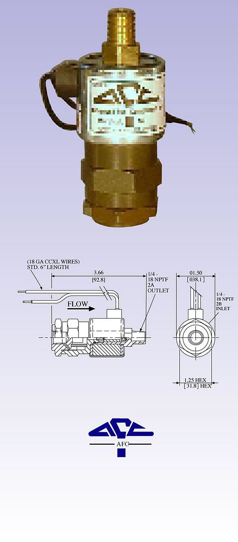

Hmmm,  I wired mine directly to the ignition coil and I have ran my Interstate Long long, fast and accelerated hard with two up and towing a trailer without any issues.
http://www.danmarcrvparts.com/12vo1orinfis.html

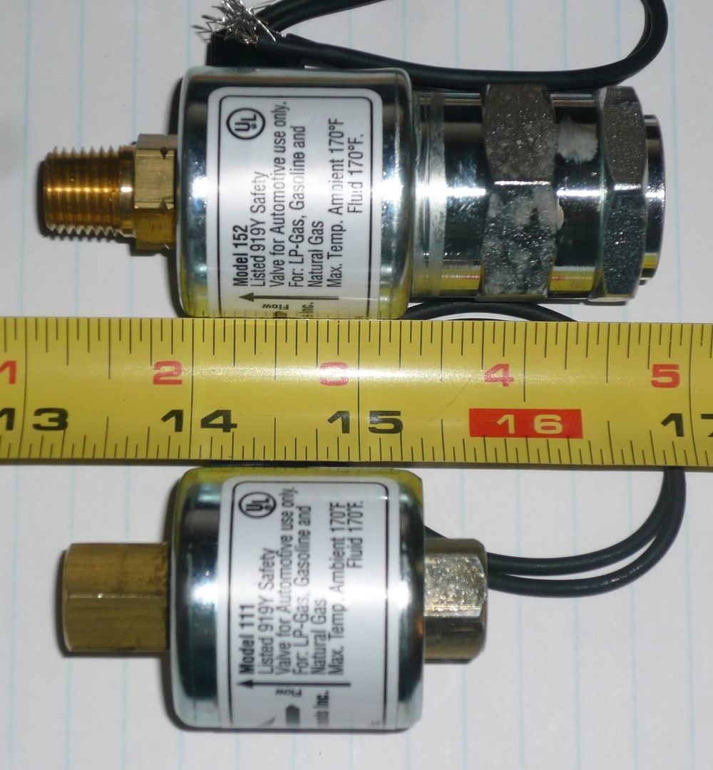

Interesting, the model you show is different than the model I have. I have the Dan-Marc model 79-AFC15212 (AFC model 111). The model you have is Dan-Marc model BR-79-AFC11112 (AFC model 152).
The Dan-Marc web site doesn't spec the current draw of either of ours and nor does the AFC (Advanced Fuel Components) web site.
The orifice in your valve is only 0.110" versus 0.156" in the valve I have. Usually this means that your coil doesn't draw as much current as the coil in the model with the larger orifice size. This may very well explain your success directly wired to the coil. I'd love to know what the current draw of your solenoid valve is (or resistance) so we can approximate the "spare" current/voltage that is available from the coil wiring. In any case the 0.110" orifice is clearly big enough if it's handling your bike at speed, two up and with trailer!
I really like the model you found. Again, AFC doesn't spec the filter size on their web site but I like the built in filter. In addition, I see it also has a magnet for trapping ferrous particles, very cool.

I just noticed that the Model 152 specs a max of 1 amp right on the label. The model 111 draws 1.25 amps. So, it looks like 1 amp or less is a pretty good guess as to the maximum draw available on the ignition coil wires for a fuel valve. 1.25 amp sure didn't work out for me. I may very well switch over to the Model 152 because I really do like wiring direct to the ignition coils. I'd love to hear from others that have solenoid valves and their experiences.

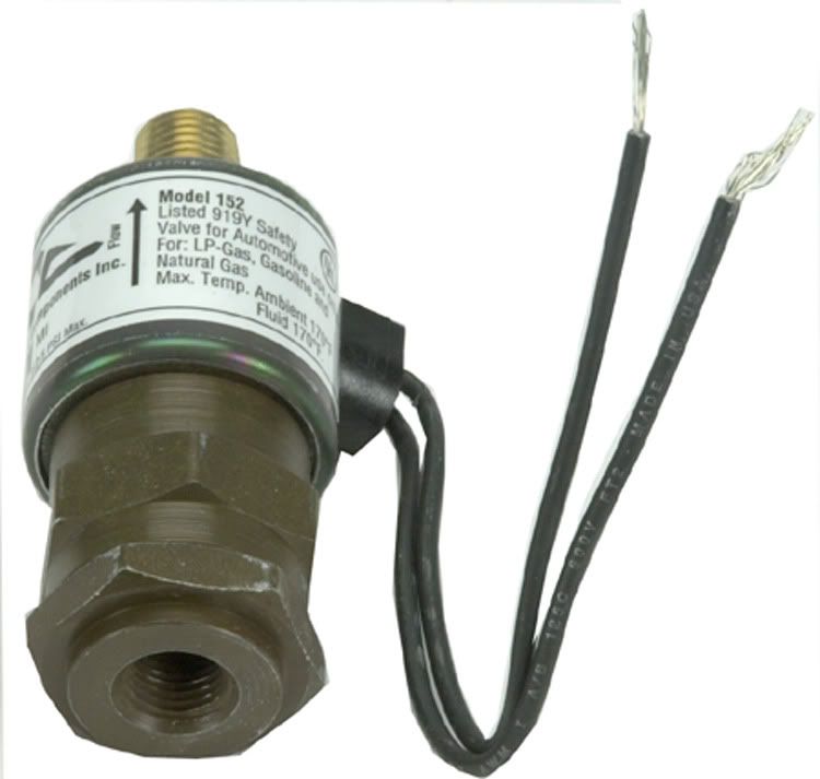

I have had both installed without any issues.  I took off and sold the unfiltered valve to a guy I work with for his dune buggy when I upgraded to the filtered model.  I wish I had held onto it for a little bench testing but I did not anticipate the need.
Actually they appear to be identical solenoid operated valves based on visual inspection of each.  One with a filter and one without a filter and with different fittings on either end.  Each with a different part number.
The label on both valves states 1 amp max.  I am uncertain where you got the 1.25 amp rating from though.  (Maybe you can clarify that rating source)    The one without a filter has 1/8" NPT female fittings on both ends and the hole in the center is larger as result of the female fittings, 0.156" while the valve with a filter has a 1/4" NPT male fitting on the discharge and even though it thread size is larger the orifice in the center is smaller.   (Please take a look at the OTHER unfiltered valve on the dan marc and AFC web sites  Item# 79-AFC15112.  That valve also has male 1/4" NPT fittings, it has no filter, but due to the male fitting has an orifice that is also 0.100")
AFC Model 152     Inline Filter Shut-Off Valve
Engineered for use in automotive, industrial, and refrigeration applications.
Features and Specifications
• Rated working pressure, 312 PSI
• 100,000 cycle tested.
• Lightweight, compact design features filter and shut-off valve in one unit
• Mounts directly onto regulator inlet
• High performance filtration capability with replaceable filter
• Resin impregnated cellulose element rated at 40 micron nominal (20 available)
• Bonded ceramic magnet traps fine metallic particles
• Ambient Temperature rating -40°F to +250°F
• Stocking 12 and 24 volt DC
• Rated for use with fuel, air and other media
• Orifice size .110”
• Superior quality construction, corrosion resistant — solid brass, plated steel and anodized aluminum
• All valves are date coded
• Every unit 100% functionally tested for low/high pressure leaks and dielectric breakdown
• Easy installation — 1/4” male pipe outlet
• One year warranty

The "orifice size" is not the hole through the fitting and has nothing to do with the fitting sizes but rather is an internal hole that is sealed by the electromagnetic plunger inside the valve body. The larger the orifice size the greater the spring force required to hold the valve closed against pressure. Because of the larger spring force the valve requires more current to hold the valve open when activated. Thus the general rule that the larger the orifice the greater the solenoid current. Also, the higher the pressure rating of the solenoid the greater the spring force and thus the greater the current requirement as well. The physical principal is Force = Pressure x Area. It's all about the balance of forces.
In the case of these two valves it appears that they used a smaller orifice in the Model 152 to help with achieving the 312 PSI max pressure rating versus the 130 psi for the Model 111. The body of the solenoid is often the same size but the internal windings can be varied to match the current requirements. (Actually there are a number of other physical changes that can be made to the winding geometries and bobbin core that also affect the magnetic forces created by the current.)
I measured my valve on the bike with a Fluke DVM, engine off, so it's only a sample of one. I changed only the rerouting of the power supply to the valve and the engine miss vanished. It only happened under hard acceleration and at high rpm. It's totally gone now.
After I last posted I found the filter specs listed for the separate filters, and if I had to do it over again I'd certainly buy the Model 152 as you did.

« Reply #16 on: February 04, 2014, 04:05:08 PM »
To install mine I used:
About 2 feet of 5/16" ID fuel line from Autozone if you don't want to cut and reuse the old stuff.
3 each brass male 1/4" pipe thread to 5/16" ID hose barbs. Got them at Autozone also.
1 each 1/4" pipe thread female T fitting. Got at Lowes in the plumbing section.
Your preferred electrical connectors and thread sealant, if any.
5 hose clamps sized for the OD of the above mentioned fuel line
One barb goes on the inlet side of the valve (where it connects to the fuel line to your tank)
The t goes on the other end on the fitting that comes with the valve.
The two other barbs go into the other two ports of the t and connect to short fuel lines that go to your carb rails.
Once you are in there it will all be obvious
While you are there think about doing the desmog and a installing a new 5/32" ID vacuum line from the petcock to the #6 inlet runner, unless you go to a Pingle.
Also some Viton inlet O-rings and some new plugs for the other intake runners, all available from Red-Eye.
Enjoy.

What does the filter look like on the Danmarc 152?
Is it replaceable or cleanable?
Would like to know before purchasing one
« Reply #18 on: February 04, 2014, 08:28:25 PM »
It looks to be replaceable , they have the filter for sale on their site.
lljjmm
Posts: 143
« Reply #19 on: February 05, 2014, 12:30:42 PM »
Found  the relacement filter/magnet  gizmo for the Danmarc #152 fuel valve
http://store.dan-marcrvparts.com/infiwima.html
However the set up cost as much as the valve combo, and it includes the magnet portion but it still states there is a cleanable/replaceable element.
I have not been able to locate just the element, does anybody know where it is to be found?
