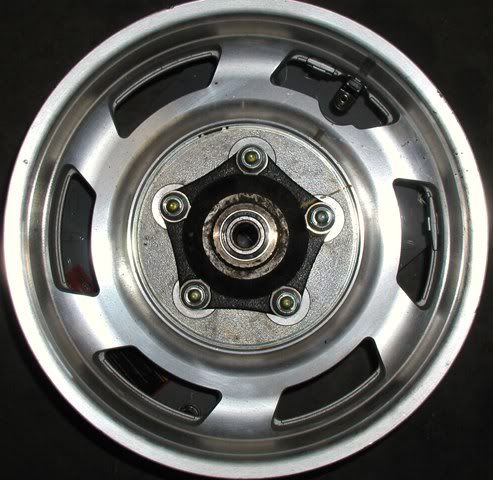

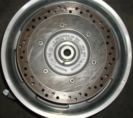

Front or rear??  I have a VTX1300 rear wheel that is very similar to Valk.  Does anyone know if it will fit a Valk??

I have a wheel on a bike that I'm not riding. I'd offer it as a loaner as long as it gets returned/replaced.

I have a rear in Houston, TX... sounds too late, if it's even the right end!  More info, please!
