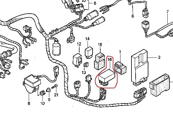

I'm assuming it's number 9 in the photo - part number is different between '99 & '00
Number 8 has same part number between '99 & '00
Also, I think you meant the right side cover ??
I think this is the unit under the side cover everyone's referring to ....
VRCC # 30938

« Reply #9 on: August 11, 2010, 08:00:39 PM »
Yep, #9 is the part.  The upgraded sensor is a little longer but the threads are the same.  As I remember the connector changed from a blade to a bullet.  I made an adapter with some crimp connectors but you could also cut off the old one and crimp on a new one.
I upgraded because I'd heard of enough failures that I wanted the improved part.  But changing the intermediate switch part is easier.  I'd have to look to be sure but I remember it being under the left cover (left as sitting on the bike, the clutch lever side).

Replace # 16 (Indicator Unit) and you will be good to go. I have a 98 Tourer that was doing the same thing. Replaced with a new Indicator Unit and the false temp overheating light does not come on anymore.      cooldude

 If I want to replace #16, which year do I replace it with? I have a 1998 so do I replace it with a 98 or 00 part?

« Reply #12 on: April 20, 2014, 06:10:20 AM »
This part does not exist on a 2000 or later Valk. Honda changed the circuit for the temperature indicator. The parts fische shows item #16 in the diagram but is missing from the part#/price list.
