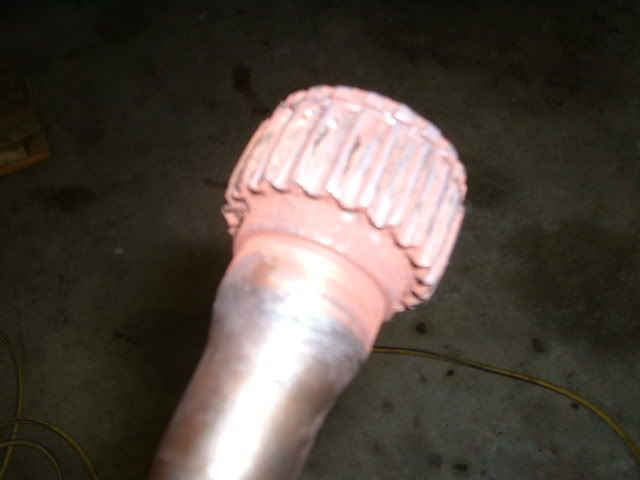

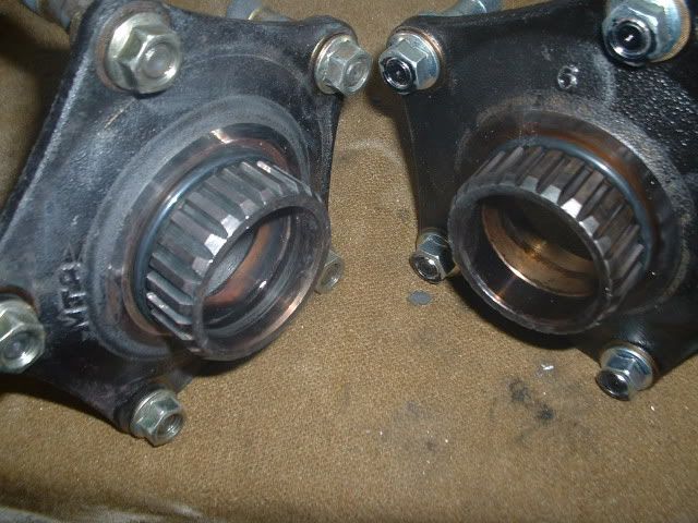

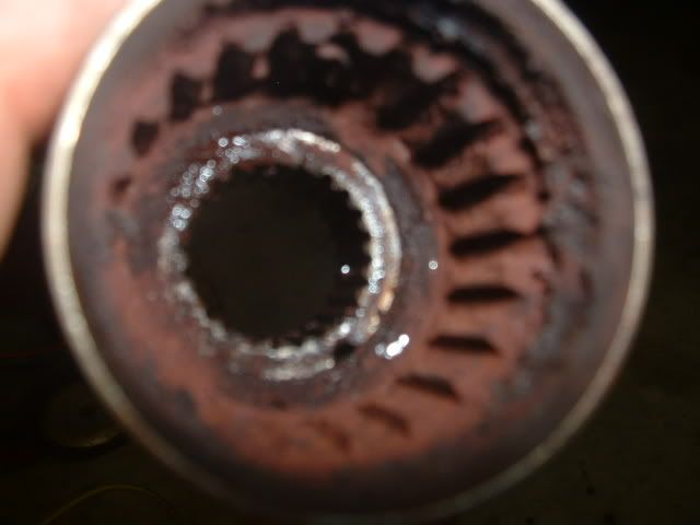

My '97 has near perfect drive hub splines but Holy Smokes was the pinion cup & driveshaft worn slap out! Rusty dusty & dry as a bone, poured out an embarassing pile of rust dust on the floor. The shaft & cup splines were 50% GONE.
Still in the process of reassembly now. Bought a very nice 29K mile used shaft from Pinwall for $29.95 & a new cup & all rear end seals from HDL. Not too bad on the pocketbook but it is a healthy job to do!
BTW this is a 102,000 mile Valk. Wink
The good. 100K hub on the left, new on the right.
The Bad.
And the Ugly.
Fix her up & keep on ridin'!!
BTW, going back together with Valvoline High Moly content grease. I will be checking the d/s splines at every tire change from now on!!!!! Cool
