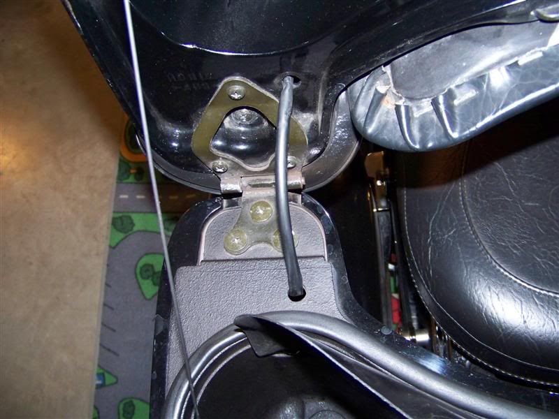

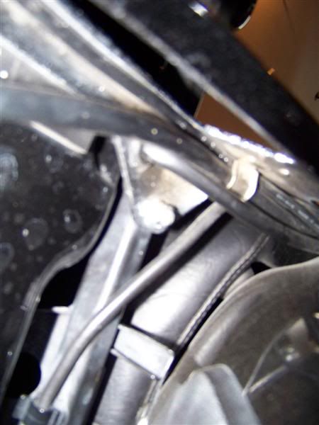

chip
Posts: 430
« Reply #5 on: September 09, 2010, 03:08:05 PM »
Hope this helps you, I just wanted to clean up the wire running up the trunk and behind the back rest.
This photo is hard to see,it is the bottom of the trunk the wire going through the chrome bracket is my speaker wire. I removed th trunk and drilled a hole directly behind the existing hole in the trunk support bracket. again it was a pain but its clean.

« Reply #6 on: September 09, 2010, 07:10:44 PM »
Alph and I did mine the same way. It's not too bad of a job other than that pulling the trunk apart includes removing about 500 screws.
