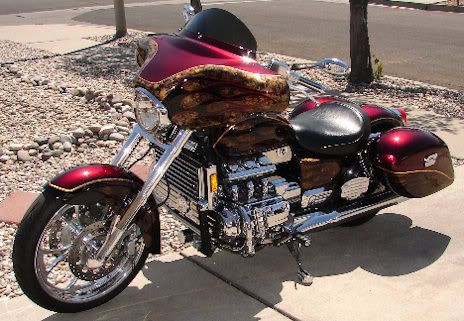

I found this picture at the Woodys Fairings site.  I want to know what size and type of front wheel this bike has on it?  Cant tell if it has a matching rear wheel or not.  I love the larger front wheel look.  Anybody?

Taking a SWAG, that looks like an RC Components VTX1800 front wheel.

Hi,
That is my bike and you are right it is a 21" front wheel.  You cn get it at BikersImage.com.  It is all bolt on and needed no mods to the front fender.  I do not have a matching back wheel. Im still saving for it but they said they can make it.
Paul

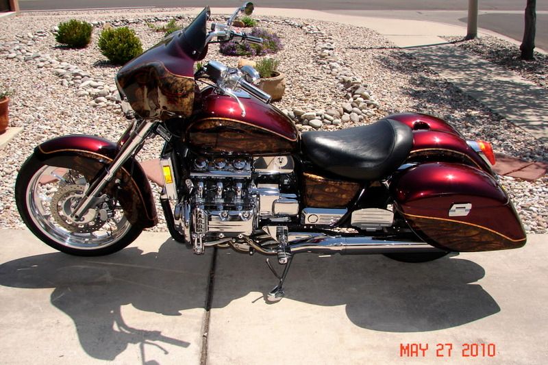

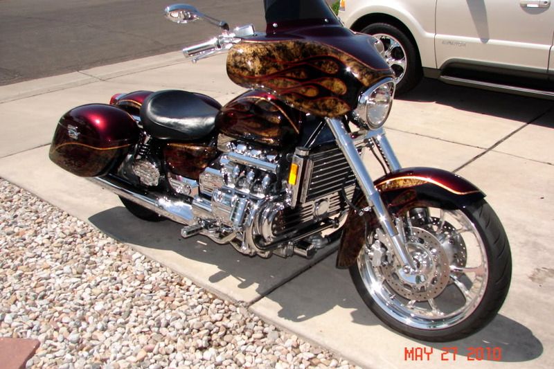

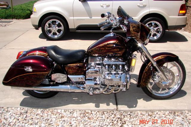

Look under the METRIC cruisers section.  I have the Duce 5.  I had to call them because they dont list the Valk.  I asked for a 23" front but they could only make a 21".  It was 1000 dollars but they were the only place I could find that would make wheels for the Valk.  I looked for a year and called everyone.  I would pay the money again, it makes a big diffrenence.  The tire size is 120/70-21.  Also you need to ask for a 21x3.5 not the 21x2.15 or it wont look right. I added a few pics.
