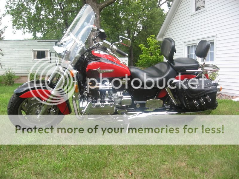

Seeing your 2000 red and black Standard make me miss mine...
The Interstate makes me feel better, but I REALLY liked my Standard.
