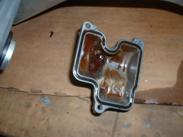

« Reply #6 on: November 25, 2010, 05:57:38 AM »
Middle cylinder left bank. Happened overnight with the petcock off.
Three things had to happen.
1} Rust/crap in gas tank had to get past the in-tank filter screen.
2} Petcock had to fail.
3} Aforementioned rust/crap from gas tank had to lodge itself under needle & seat on the carb.
This happened to my '97 in 2007 with 78,000 miles. Thank God no damage! Tank was rusty inside which I think is the initial problem. Even if you have NO petcock of any sort or a positive never fail fuel shut off, trash under the needle & seat is the root cause of the problem & will cause a problem of some sort sooner or later.
I put a new stock petcock back on because I like the convienence of the stock design. I had the tank cleaned & coated plus I installed an extra in-line fuel filter. Since then we have purchased 2 more Valks, both of them with non functioning stock petcocks {no reserve is how I noticed}, both from sitting around not being ridden much. Neither one caused a hydro-lock because they have had no needle & seat issues. Both gas tanks look to be MUCH cleaner than my '97 was. Used the Honda petcock rebuild kit & replaced the screen on both of them & the reserve function is fixed.
That's my story.
