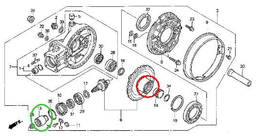

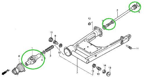

After reading several posts on lubing the splines I can see where people get confused and make the wrong choice for lubing the splines. What IS confusing is the use of the term "splines". There are splines on the drive shaft and pinion cup and there are splines on the driven hub/flange (wheel).
From what I can decipher from what I've read so far and what the manual says is to use MOLY GREASE on drive shaft/pinion cup splines -and-  MOLY PASTE on the driven hub splines.  Also, the type/brand of GREASE or PASTE in those area's varies widely.
Bel-Ray WP grease comes up alot to use on the "splines" but not always clear which splines.
Sorry for bringing up yet another Spline post but thought it should be clarified what "Splines" are being talked about. I doubt I'm the only one that is a little confused ....
And PLEASE .... lets not get off on a tangent with the vent hole thing (pinion cup) ....  Roll Eyes
So for the record is what's shown below correct ??
Green = Grease  (example: Bel-Ray WP Grease, Green Grease, Guard Dog 525, Valvoline Moly blend)
Red = Paste (example: Guard Dog 570, Bel-Ray Assy Lube) - Honda 60 NOT RECOMMENDED

I'm afraid I disagree with a wee bit of your post. The 60% moly paste is not a very good grease for the wheel splines. Honda's paste is not waterproof and tends to wash away. Rust sets in a grinds away on the splines. The Guard Dog and Bel Ray are better choices for wheel splines. On the two drive shaft splines, I use Valvoline Moly blend. It's a 3% moly mix of synthetic and conventional waterproof grease. Now have 117K on the original shaft and wheel splines with no problems.
I would have to agree with that - I put it in there cause the manual calls for it - My experience with the Honda Moly 60 on my GL1100 was not favorable.
I'm assuming when you mention Guard Dog you are referring to 570 for the wheel splines.
Also, I edited my original post .... I had "Grease Grease" instead of "Green Grease".

The manual calls for 40% minimum moly content paste for the hub gear and splines.
Bel-Ray Assembly Lube is 40% moly paste.   Honda 60 is 60% moly paste.  I believe both of these are moly mixed with oil and include clay as a thickener.  Guard Dog 570 is 73% moly in a grease.  I'd use any of the three in the hub (the red zones.)
If you service the final drive every 10,000 miles or at every wheel change, whichever comes first, and your o-rings are good, and you avoid pressure spraying your rear drive, the paste should not be dry at service time.
The manual calls for 3% minimum moly content grease for the pinion cup, drive shaft, u-joint, and output shaft. (a light coating in the green zones.)  Many (including me) just use a high-pressure waterproof grease for this such as Bel-Ray Marine grease.  I believe the Bel-Ray is NOT compatible, and should not be mixed with moly containing clay additives.
The moly content coats the surfaces of the metal parts and greatly reduces the coefficient of friction on parts that mesh or slide.  (It makes them slicker.)
Why the difference in specified lubes (40% moly paste vs 3% moly grease?)  I believe it is due to the difference in forces experienced by the components in question.
