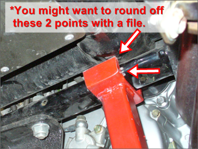

....does this [betterbuilt-mc-co] stay on the bike (ie bolted to it or does it come mount to the lift).
2 L-bolts attach the betterbuiltĀ® adapter to the engine for "temporary" mount. If you do decide to buy it, it's wise to tighten the L-bolts sufficiently because a number of people have forgotten that it's still on the bottom of the bike until after riding for a few miles down the road. For example, you left the adapter on the bike the night before to do some work the next morning, but decided to take a quick ride to the store. Unfortunately the adapter does not mount also to the lift jack arm as the Ross Spoonland version. (Photos from an earlier thread.)
