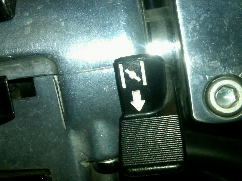

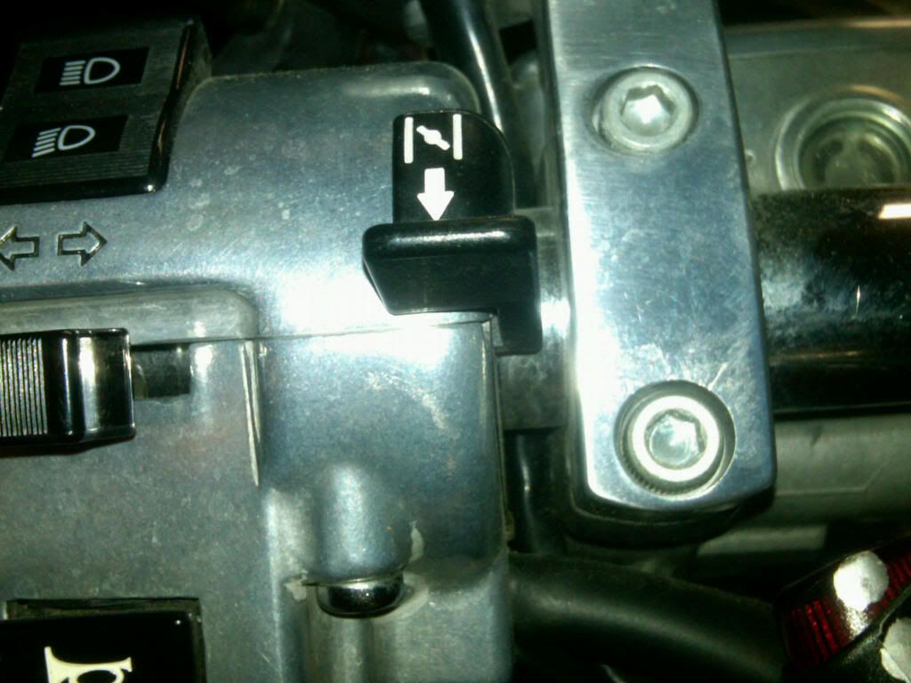

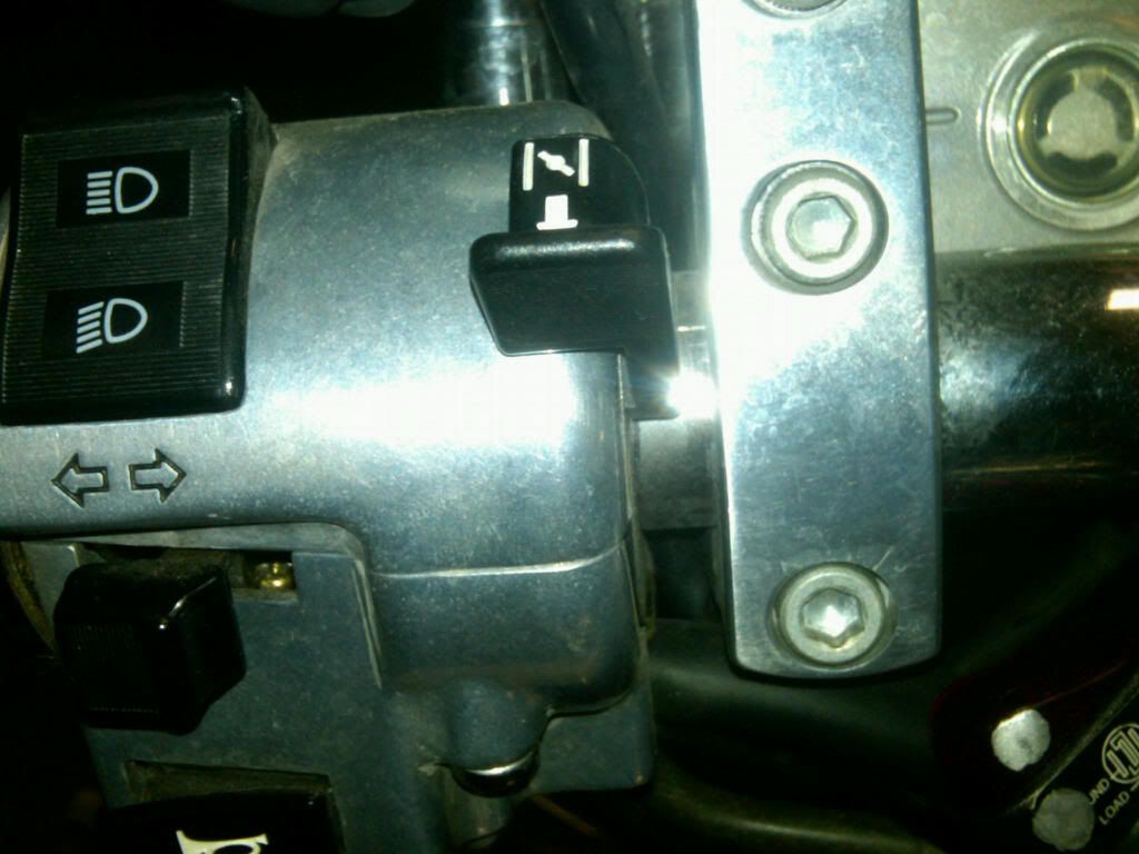

take the advice on the "choke" a lot of new owners make that mistake.
and like was said before tell us where you are and we need pics Smiley

If you are putting a bottle of Techron in your tank to clean out the pilot jets, DO NOT ride it like you stole it.  In fact, don't go above 3,000 rpms.  If you do the needles will lift from the primary jets and you won't be cleaning the pilots.  Go riding and just cruise.  You're riding with a purpose.

« Reply #39 on: March 06, 2011, 09:17:01 AM »
No choke.
You think your choke is full on, but its not.
Full choke.
« Last Edit: March 06, 2011, 11:30:44 AM by valkyriemc » Logged
