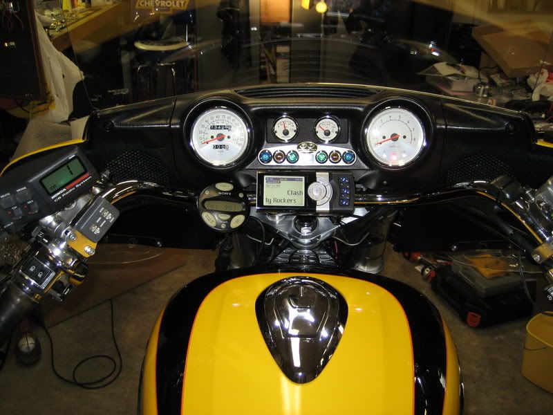

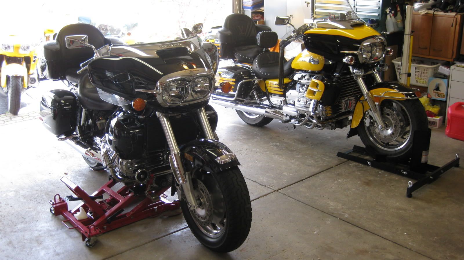

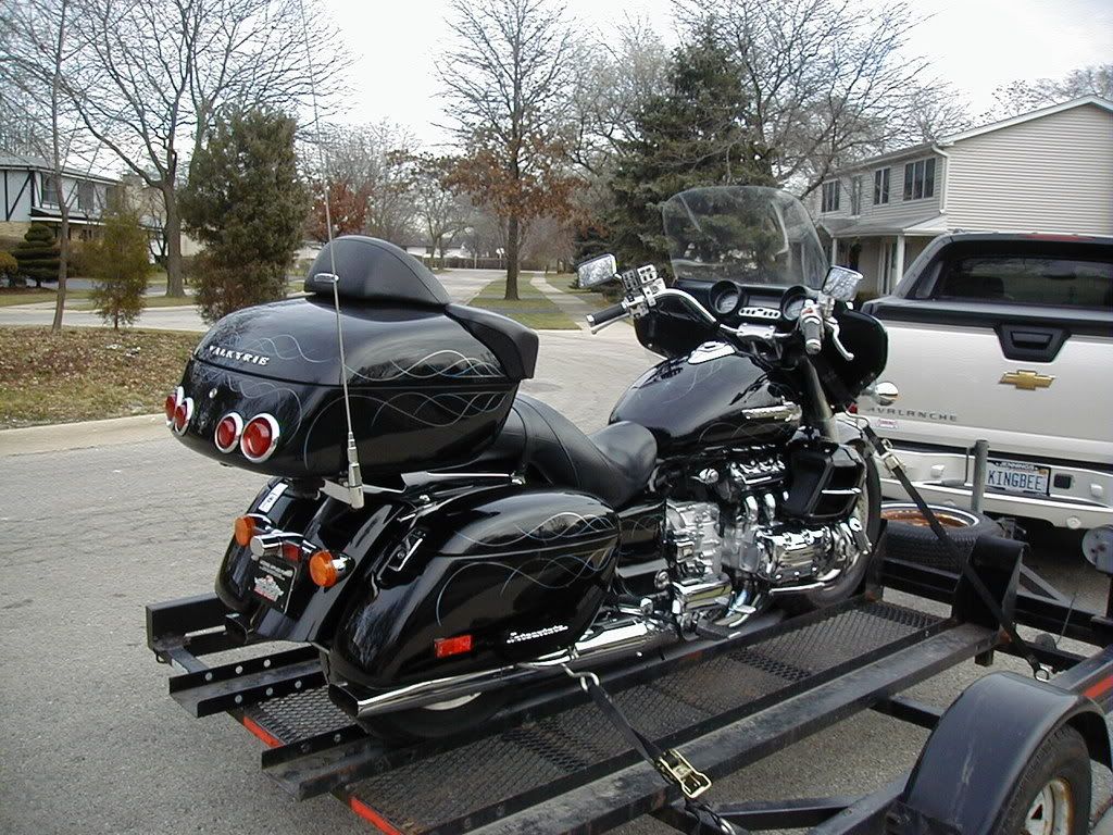

Late last November, I bought a 99 Interstate with 20K on it, just to play around with during the winter. Now it's fully serviced, and runs great.
I called my dealer today, and told them to take my bike out of the service que.
I'm going to swap all my painted parts, locks, shocks, forks (easier than changing out the progressives), accessories, chrome, centerstand, tires & wheels between the two bikes, and gain 60,000 fewer miles in the deal.
Then I'll sell the troublesome one to a dealer & let him deal with it. This beats the heck out of my service department racking up a $1,000 bill & again not finding the problem.
So, this interstate
Will turn into this
Anyone want to buy a black, pinstriped, Tourer/Interstate clone with a stereo, CB, Audiovox cruise & heated grips?
