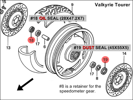

As I look at the parts break down of the front wheel,
are there really two seals
(dust seals) on the left side(clutch side) and only one on the right side?
Might be a project this week.

I just replaced both front wheel bearings a couple of days ago and there is only one seal per side....at least on the Interstate with the electric speedo.

Re: Front Wheel Seal(s)
May 08, 2011, 12:00:06 AM »
2000 Valkyrie Tourer

when I redid my fork seals I found a bad seal on my left front and luckily had some already on hand..mine is a 2001 std and only has one seal per side.

All these pics are available online through the fisch that most sites have for parts. Gives a very nice exploded view of the parts that make it up. The manual tells us how to remove them, but I really line knowing what parts there are.
