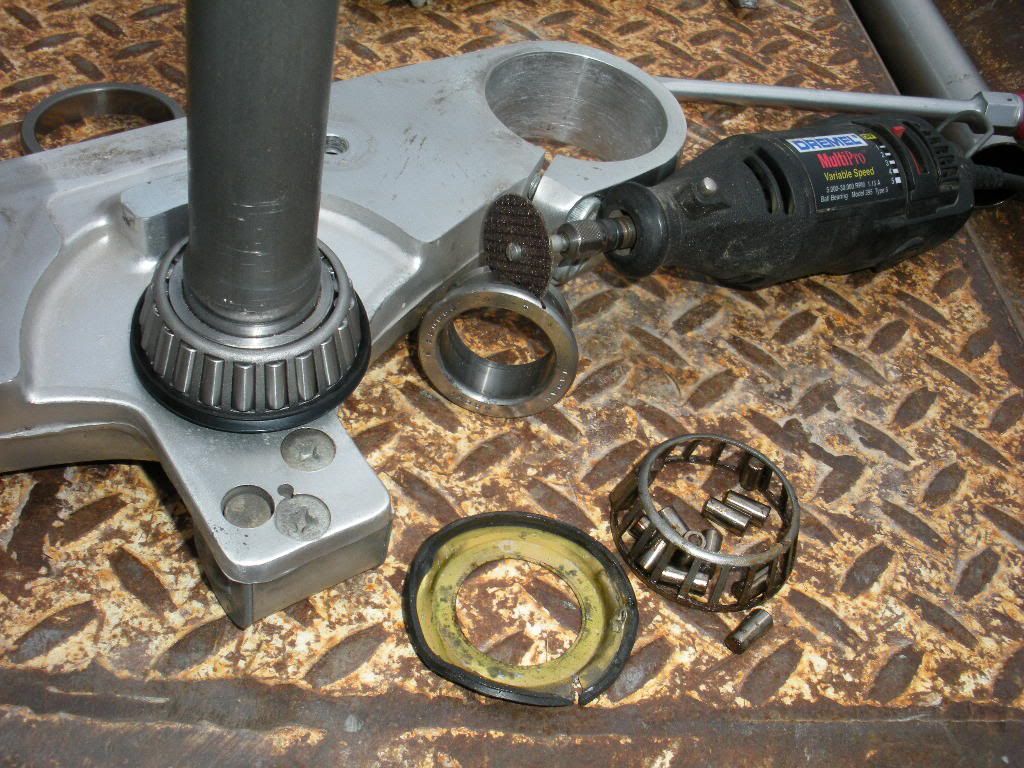

Well I am going thru the same thing. Noticed it when the bike was on the lift  and no weight on the front. That made me think it was the top bearing............. wrong  on that (just don't tell my wife  Evil) The more stuff I removed from the front the more profound the issue became. When I got to this point I could feel all the indexing 5-6 times from full left to right

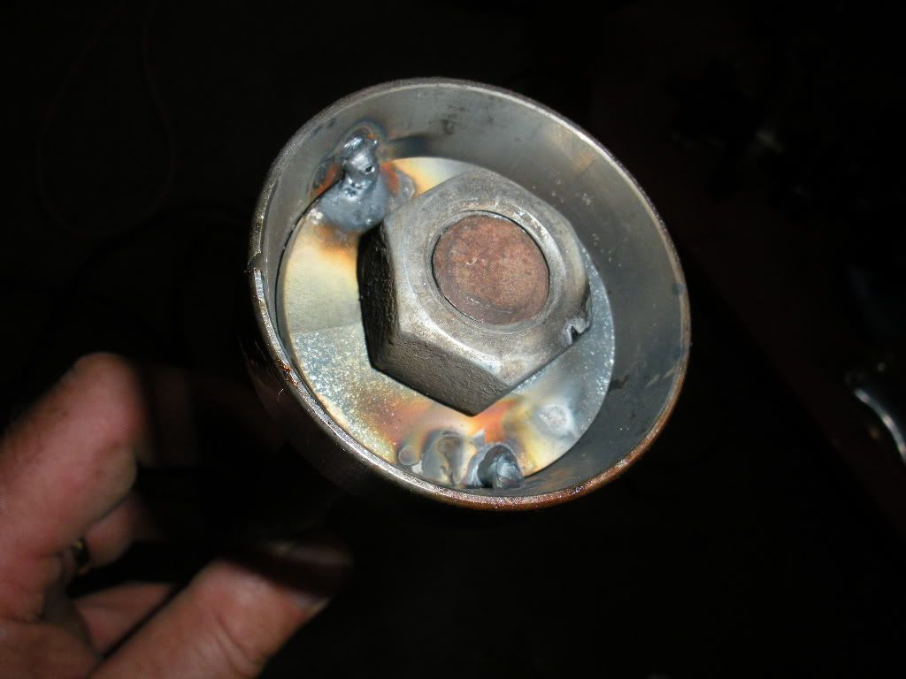

That's what the bottom race looked like after I cleaned it and this is how I removed it without the special Honda tool
Just used my TIG welder and welded a flat washer to the old race while on the bike.
That's how it came out.... easy after I figured out how!
What would I do without a dremel. It made short work of the lower bearing on the steering stem
Thanks to the DFW VRCC   cooldude cooldude cooldude Football I will have everything back together tonight!!  This is after 60K miles How many miles on yours.TJ

Here is a tip for those with a welder. No need to weld a washer on to the race. Just make a few short beads across the race, it will shrink and fall out. Thats how I do it. 3 short beads, and it will fall out.
Should those welds be radial or bias?
Jeff K
Posts: 3071
« Reply #13 on: May 13, 2011, 06:43:50 AM »
Radial, across the bearing not around the bearing race. I have a picture somewhere, but I can't find it now.

I did not see anything like that on my 2000, perhaps it's exclusive to earlier models like yours.  Never-the-less it sounds like extra work, the advice given to me was to use a dremel just like the example above. Worked like a dream. cooldude
