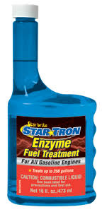

If you have lousy 10% ethanol in your gas (like I do), I use StarTron fuel enzyme for any storage periods.  Also in my gas cans for power equipment.
