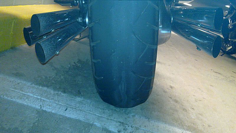

« Reply #14 on: August 25, 2011, 11:00:25 AM »
Well
Mother Nature provided me a surprise opportunity to try the tire out in rain thins morning ( yes, my jeans are just about to dry up after a few hours, thanks for asking ) and it did not feel too bad in the rain. Obviously I was not pushing too hard as it really was pouring down for a little while, but wet traction felt pretty good. Actually based on my butt instinct, I would already rely this tire more than the E III that I had previously, in the rain especially.
Bearing in mind of course that my butt is a highly subjective measuring instrument  Cool
IBA #54465

« Reply #15 on: August 25, 2011, 01:39:25 PM »
I have an '01 Interstate and have been running Dunlop Elite 3's for the last 5 years with good mileage.  Has anyone had any experience running the Bridgestone Exedra G702 on the rear of a Valkyrie?  If so, what did you think of it.  The reviews I have read range from average mileage to great mileage on the rear.  Some reviews indicate it is not very good on wet roads.  I can get a great deal on this tire but do not want to sacrifice handling or mileage.  All comments welcome.  I have a Bridgestone Exedra on the front and have been running it for 2 years and it performs well.  Thanks in advance.
I'll let you know as soon as I got my Exedra 702 (should be at my door on Monday ). Heard some positive comments on handling and durability from GW riders so thought to try it myself. Besides I'm getting a bit tired my ME880's ending up looking like this in a hair under 8000 miles....  Undecided
Sigrun, that looks to be a stock size ME880. Big mistake on the Valks. Until I went with a c/t, I used the Metz ME880 in a 200/60-16 in back, running 42lbs. psi and never had it down to the threads.  In the two that I didn't tear up with something I picked up on the road, I got 12k miles. Two had well under 5k when a large puncture destroyed it so I don't count those. I've seen a number of riders change from the stock 180 size to the 200 and nearly doubled their mileage. I still run an ME880 in front with the c/t, this one is fairly new but it replaced one with 16k on it.
Hoser

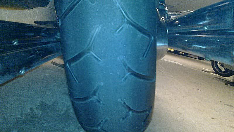

« Reply #17 on: August 25, 2011, 03:23:47 PM »
2500 miles on new tire...... still looks new...
G702

« Reply #18 on: August 25, 2011, 04:10:05 PM »
Well well well....
Thanks for the tip John, I was not thinking of that. Yes, it's bone stock ME880 180/70-16 and like it's predecessor did not last very long. Once this 702 is done for, I might as well try 200 to see about them apples. Did the size change make any difference on the cupping of ME880 as well?
IBA #54465
Posts: 15369
« Reply #19 on: August 25, 2011, 04:19:20 PM »
Well well well....
I never had a problem with cupping either front of rear. I ride solo and kept them at 40/42psi, front/rear. They are a softer compound so if you're a hard rider your mileage won't be as high as my 12k average. But overall, the only time I noticed it was time to change was around 11-12k the rear started to gator back down the center. Still rode ok, just a bit noisy in the curves when it rolled off the center.
One additional item....the Metz are known for sticking good, especially in the rain.
