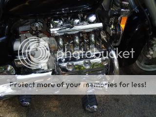

I've got some mounted in this configuration right now.  I'm 6' 7" and they worked pretty well first time out.
