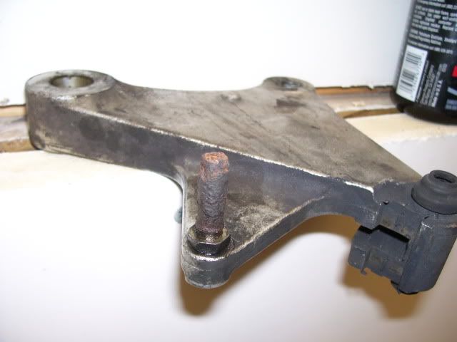

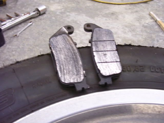

Another thing to check if your rear brakes suck is the pin that the caliper slides on. When I first got my Valk the rear brakes were terrible. When I took them apart this is what I found.
The caliper was stuck fast to the pin. Would not budge, let alone float like it is suppose to. Here are the pads. One half worn the other toast.
Bought a new pin and oem pads. Muucho better now.
John
« Reply #17 on: September 26, 2011, 01:14:31 PM »
The pin that the pads slide on is important to keep clean too. There's a moving-target area
on the pin that stays clean-ish while you're wearing your pads down, but when you
change to new thick pads, the clean place is not where your pads are anymore, and the pads
don't slide out away from the rotor so easy when you're not on the brakes... the first time
I rebuilt my rear caliper, I didn't clean the pad-pin, and the rotor got hot enough to sizzle spit...
I thought about what was going on, came up with the pin idea, cleaned it, and problem solved...
