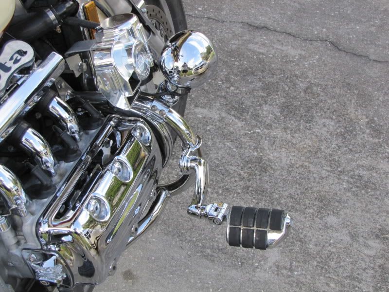

I like the looks, and was prepared to buy a set.  As I was shopping around on line, I came to one site that had just review after review saying the mount drags in corners.  How's it work for you?  I normally try to weigh good reviews against bad.  But this was just one after the other saying that.
I have 2 sets of pegs, and a mount from Longhorns, so I just mounted some Longhorn offsets on the vertical part of the bars.  I have a 31 inch inseam.  This is comfortable if I lean back against the backrest.  And it could swing in just a bit more also.
